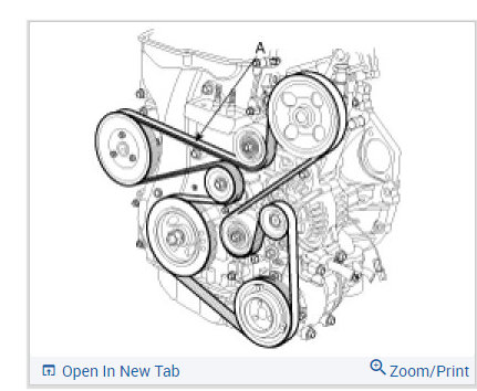

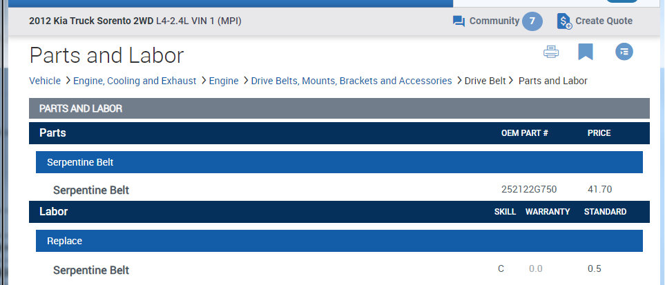

Can the A/C compressor be bypassed in the vehicle listed above and if so what is the belt size?
Jan 11, 2021 at 5:59 AM
You can bypass this compressor by just measuring the pulleys with a piece of string routed as shown but not around the compressor. Then you will have to buy the belt that is a little shorter then this measurement so that you can have the tensioner take up the slack. You have to do it this way because they don't list a belt with no A/C so we don't have a size to give you.
