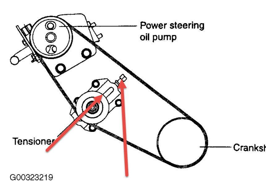

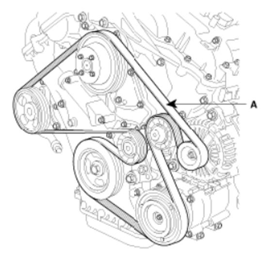

Replacing the drive belt and do not know the routing of the belt that is all the problem I have at the time I need a diagram that I can look at in order to rout the belt in the correct way to work on my car Please ans as soon as you can since I need the car for work and I am missing work right now owuraj japotjopej paouap patiptrj pati tr
Jan 7, 2014 at 1:06 PM
HMAC300
  • 48,601 POSTS
see pic make sure to replace tensioner as well. Check out the diagrams (Below). Please let us know if you need anything else to get the problem fixed.

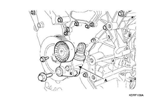

Thanks. It worked and got rid of the noise. One more thing. When replacing the belt, does the tension need to be changed on the belt tensioner and if so how?
Aug 17, 2019 at 7:37 AM (Merged)
HMAC300
  • 48,601 POSTS
its usually one piece in the pic it shows it it bolts with two bolts andyou just move it away from belt unhook belt then unbolt and reverse to replace.

How do you get the tensioner to move to loosen belt?
HMAC300
  • 48,601 POSTS
Loosen the bolt so the tensioner pulley moves up then when replaced tighten belt and use a belt tensioner gauge so it 's not to tight, auto parts may rent one.

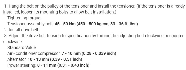

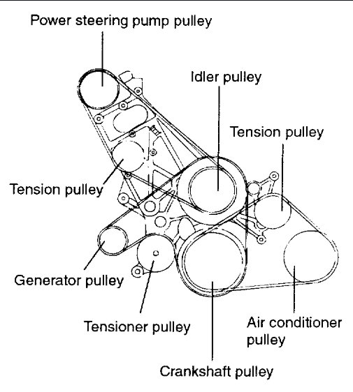

Can you please give me step by step instructions on how to install a new alternator accessory belt? Alternator accessory belt fell off. Do i need to first take off the A/C belt? How do i know how much to tighten tensioner? Please help.
Jul 21, 2020 at 7:24 AM (Merged)
DANNY L
  • 5,648 POSTS
Hello, I'm Danny.
Yes, You must take off the A/C belt first,then the power steering belt second,and then the alternator belt is third which is the farthest back. I've attached below the specifications for your vehicle. Hope this helps and thanks for using 2CarPros.
BRADYA
  • 5 POSTS
These are the number i have looking for! Thank you, for answering my questions. Much appreciated...
