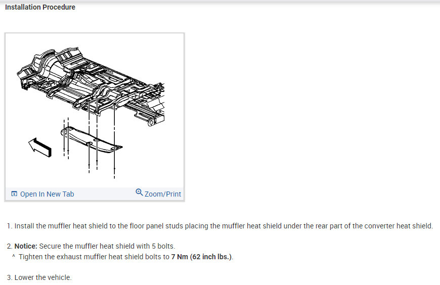

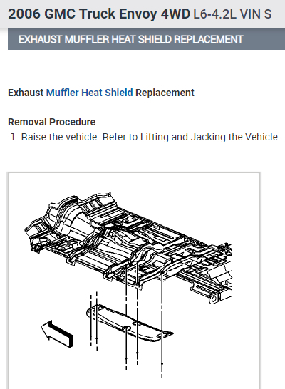

It wont load up but i think i figured it out the heat shield on the muffler is broke off and just laying on top of the muffler. i moved it and it sounded like that noise .so i'm going to tape it up to see if i hear the noise anymore. thank you for all your help though.

Hello, I'm Danny.
I've attached picture steps below to help aid in the fixing of the heat shield on the exhaust muffler on your GMC truck. Let us know if this helps and get back to us if you have any further questions on this issue. We can send you all other exhaust heat shield instructions or instructions if needed. Hope this helps and thanks again for using 2CarPros.
