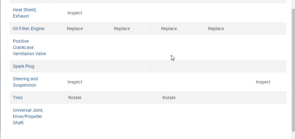

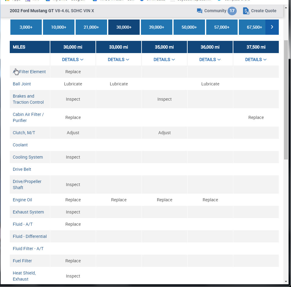

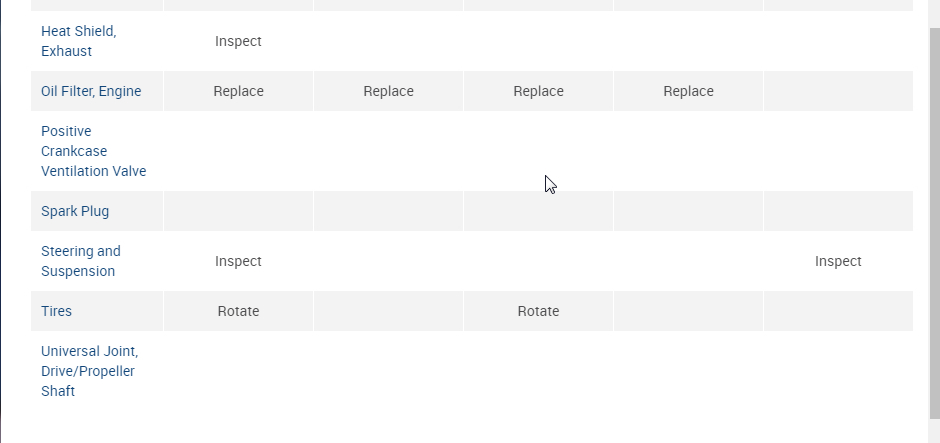

As for the maintenance, there is nothing special or much different then Honda. Change the oil every 3,000 miles, and rotate the tires every 6,000. Then air and fuel filters no more then 15,000. I attached the service that needs to be performed every 30,000 as that is the largest for these vehicles.
