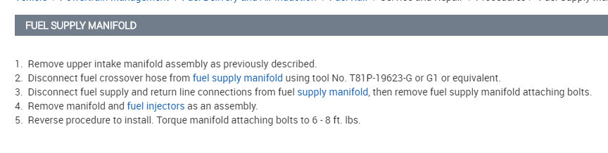

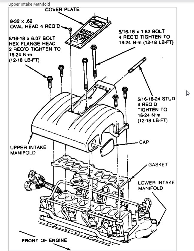

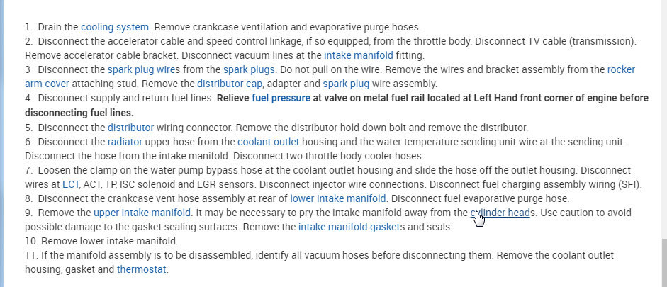

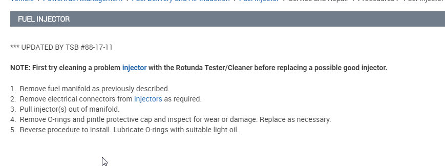

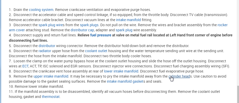

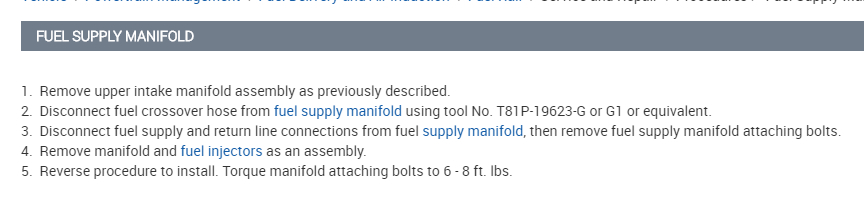

Is there any service info on removing everything and torque values it’s listed above and it is an Ltd. I have never messed with one of this and is there any diagrams of it?
Aug 21, 2020 at 12:32 PM
SKOOTER24
  • 275 POSTS
I really need help on this one.
Aug 22, 2020 at 6:59 AM
Sorry for the delay. Are you looking for information on the fuel injector replacement? If so I attached that. If something else let me know what that is. Thanks

If I remove the distributor will it lose time?
Aug 23, 2020 at 11:49 AM
The engine will not come out of time and if you tape down the rotor so it doesn't move then you can put it back in where it came out. You just want to mark on the engine where the rotor is pointing. However, if it were me I would just put the engine to TDC for number 1 and then mark the position of the rotor on the distributor for when you pull it out you know where it is pointing for number 1.

Yes it does and if i go to check injectors can’t I use a injector tester and what would be the drop I need for all injectors?
Aug 24, 2020 at 12:32 PM
Are you talking about the tester that turns on the injector and then you monitor the drop in pressure of the fuel system?
If so, there is no specification for this but as you pulse the injector, you should see the pressure drop around 5 PSI if you pulse it for a second or two. The faulty injectors that you will find is after testing all of them when one or multiples don't drop any pressure (they are not opening) or it drops considerably more then the others as this indicates it is hanging open.

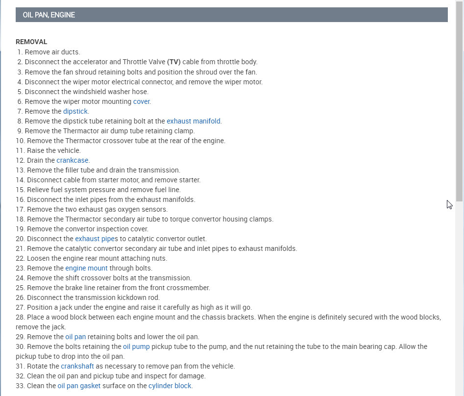

Okay, I now hear engine knock. can’t I open the oil pan and change the rod bearings in there for now?
Sep 9, 2020 at 8:39 AM
This could explain the low power as well. However, post a recording of the knock because this may not be a bearing noise. Does it get faster when you accelerate?
You can drop the oil pan and look at the bearings but if you have metal through the engine then you are going to need to go through the whole engine because that metal most likely damaged a lot of bearing and the only way to know is to rebuild it.
I just would not want to see you go through all that trouble just to put it back together and it still make noise.
I would at least start with dropping the pan and seeing how much oil and what the crank bearings look like.
Post some pictures of the bearings if you can. Thanks

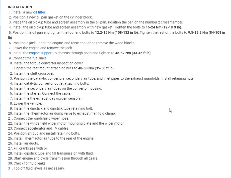

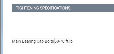

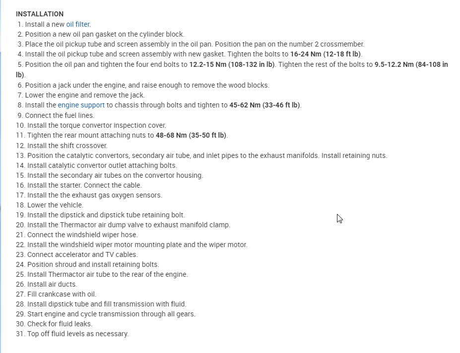

That’s what I’m going to do. is there any torque specs and procedures for removing everything?
Sep 9, 2020 at 11:23 AM
I attached the process for the oil pan. The instructions on these older vehicles are not very detailed but more of a list. Also the torque specs for the crank bearings.
Let me know what you find. Thanks

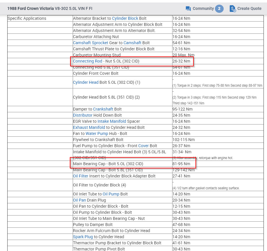

I’m going to try and save it and I need one more thing. is there torque specs for the rod bearing caps?
Sep 10, 2020 at 12:02 PM
Haha. Sounds great. Be sure to keep us posted on how it turns out.
Sorry, I thought I gave you that. I attached and circled the connecting rods and main bearings.
