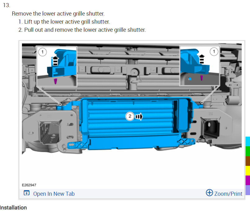

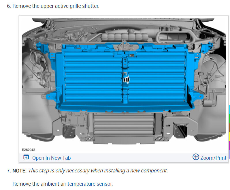

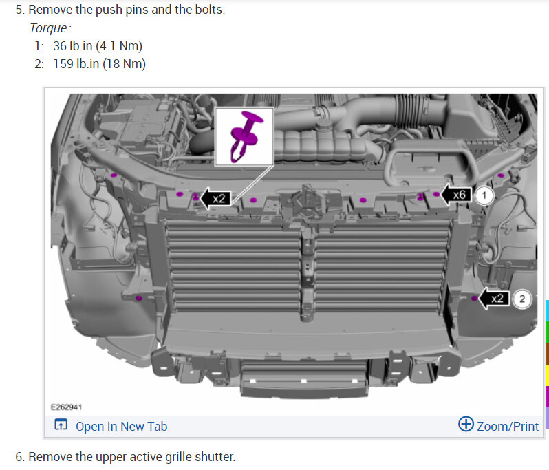

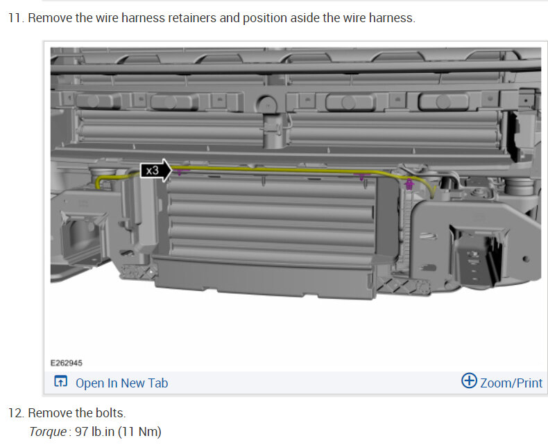

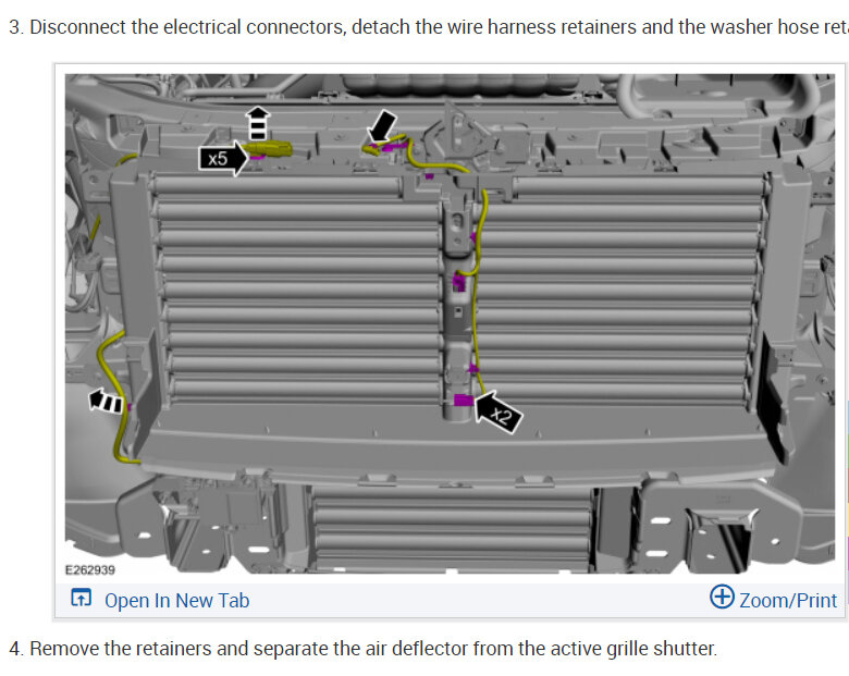

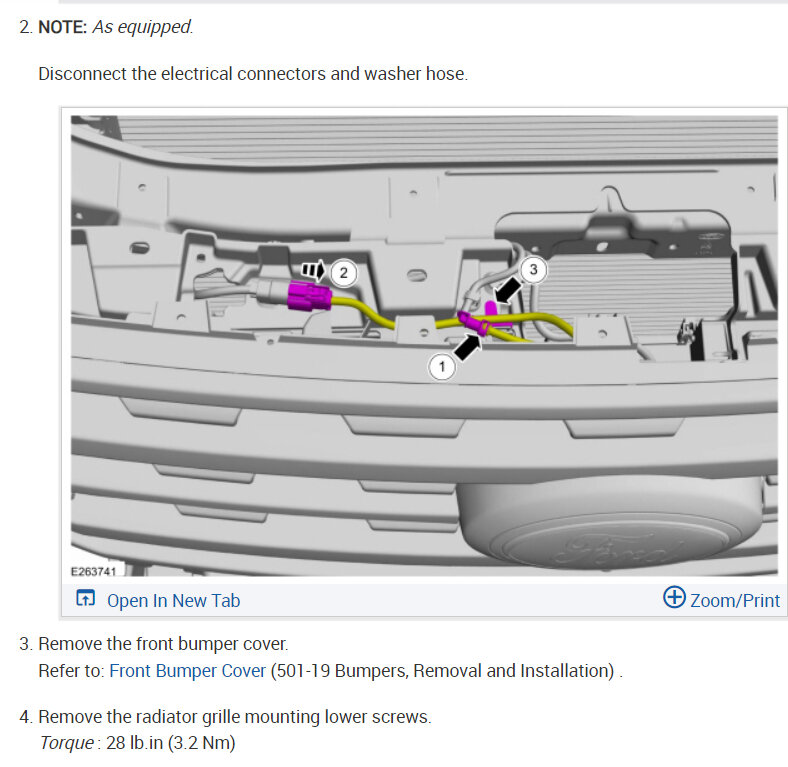

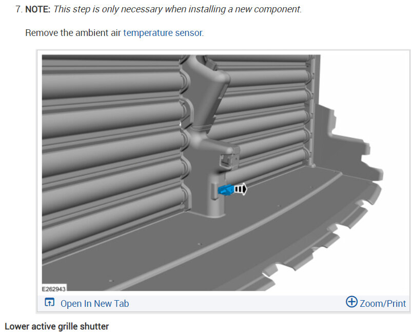

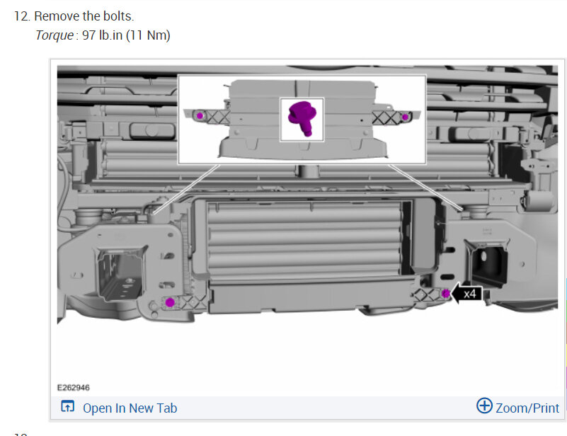

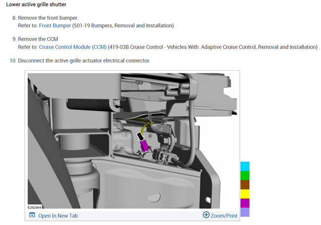

Apparently there is an upper and lower active shutter assembly. Here is the price for the parts and the instructions on how to change them out.
Radiator Shutter Assembly
Lower JL1Z8475D $514.95
Upper JL1Z8475C $1087.05
The book gets
Lower 1.5 HRS
Upper 2.1 HRS
Oct 23, 2024 at 4:21 AM

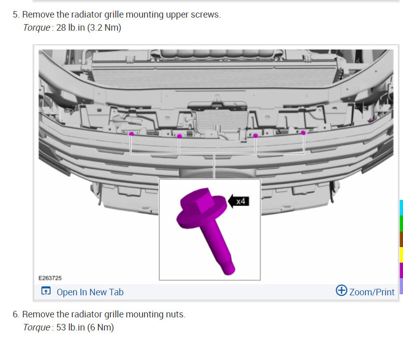

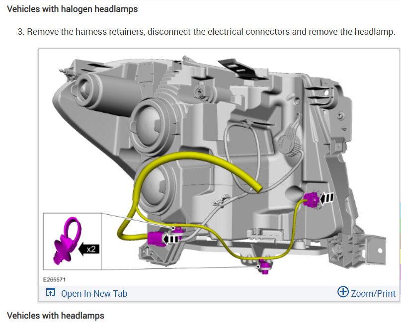

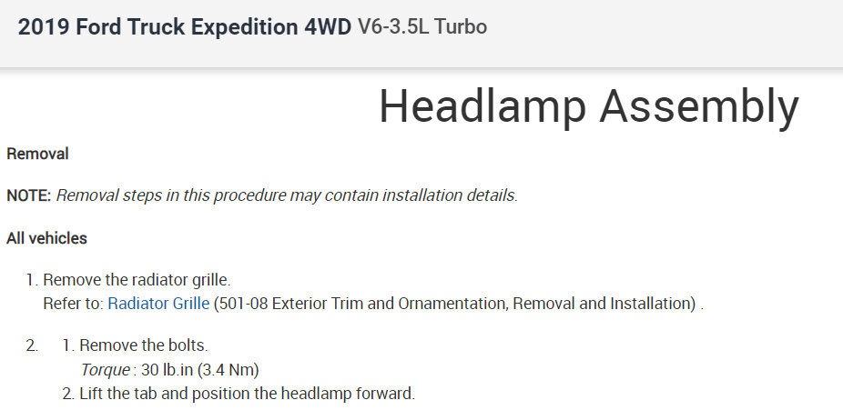

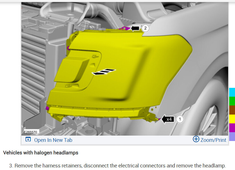

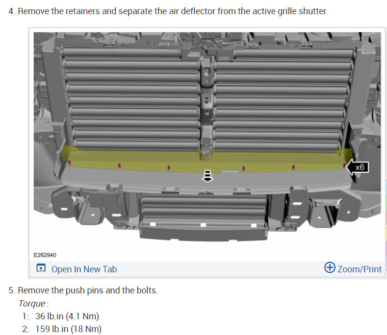

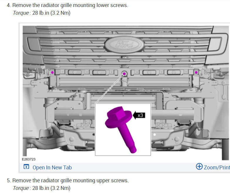

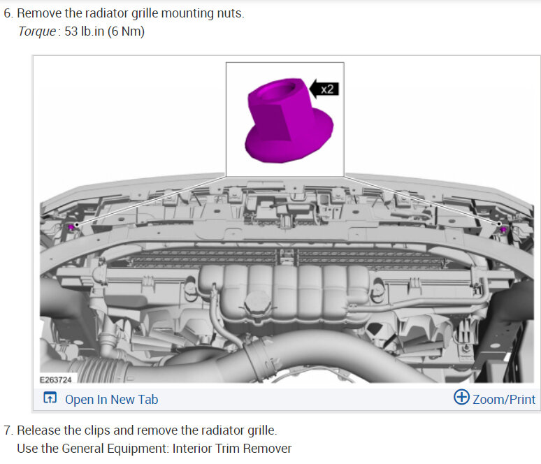

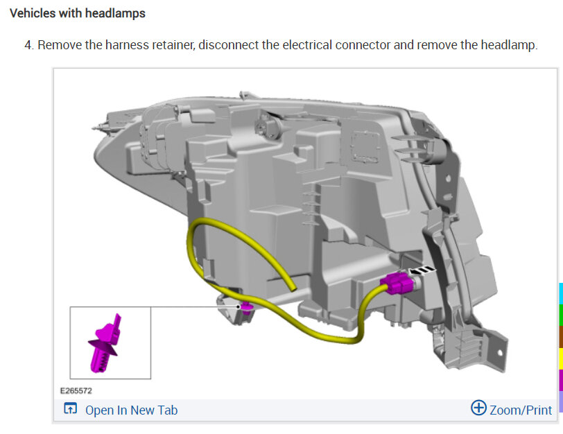

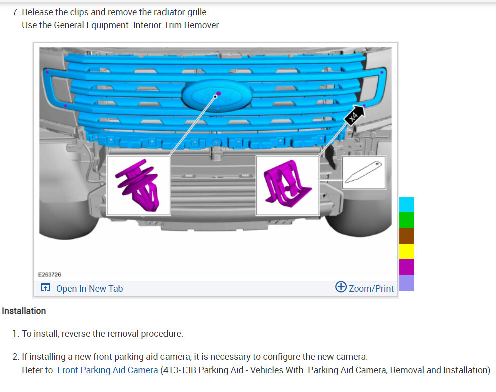

A appreciate the pictures. Can I assume also that the bumper cover must be removed? If so, what is the procedure for that?
Second, what if both of the shutters are missing? Is it a big problem? Previous owner went two years with them as is and reported no issues.
Oct 23, 2024 at 2:05 PM
  • 55,851 POSTS

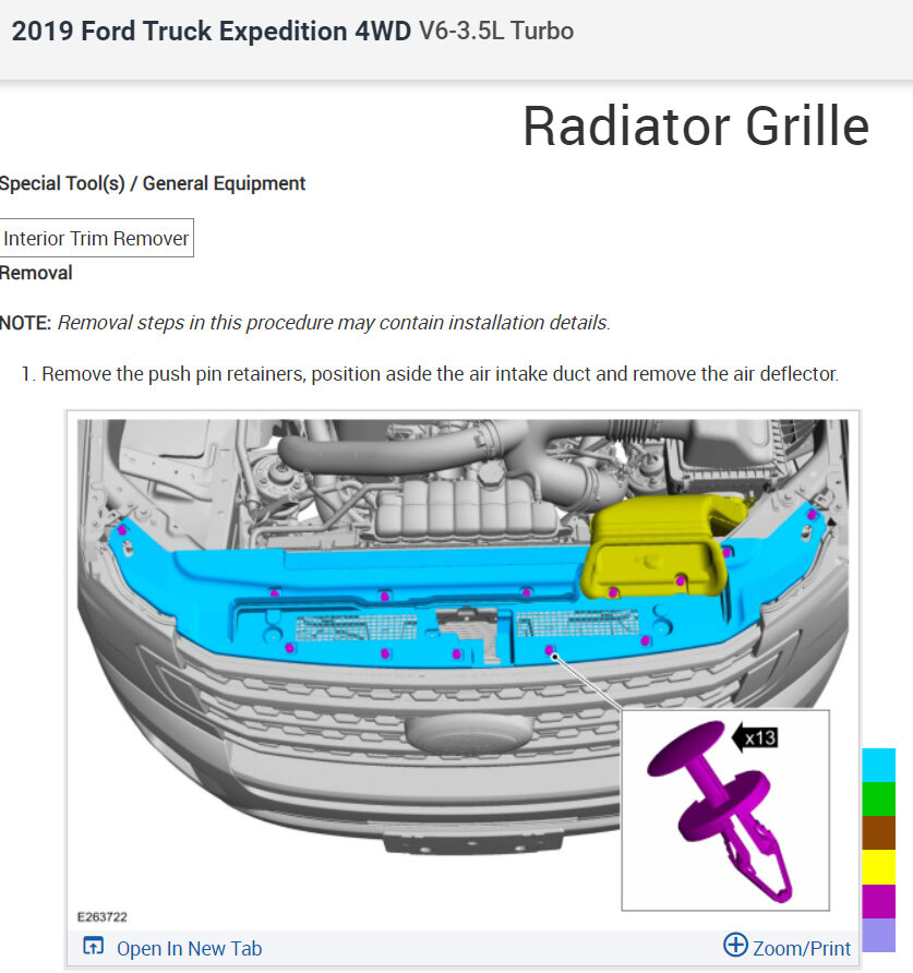

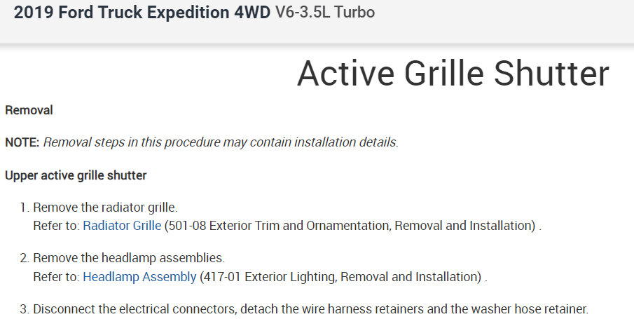

They will cause the check engine light to be on with trouble codes. Yes, you need to remove the front cover to get at the shutters. Here is how to remove the grill and headlights. Check out the images (below). Let us know how it goes.
