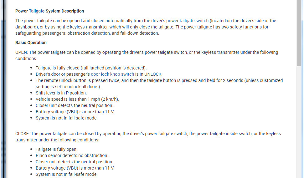

Okay. Just to be clear. The auto lift and close function is not working at all from any button but you can manually open and close it?
Does the vehicle beep at all when you press the button? If so, how many times?
We need to check for codes as you may have some body codes in the computer that will point us in the right direction.

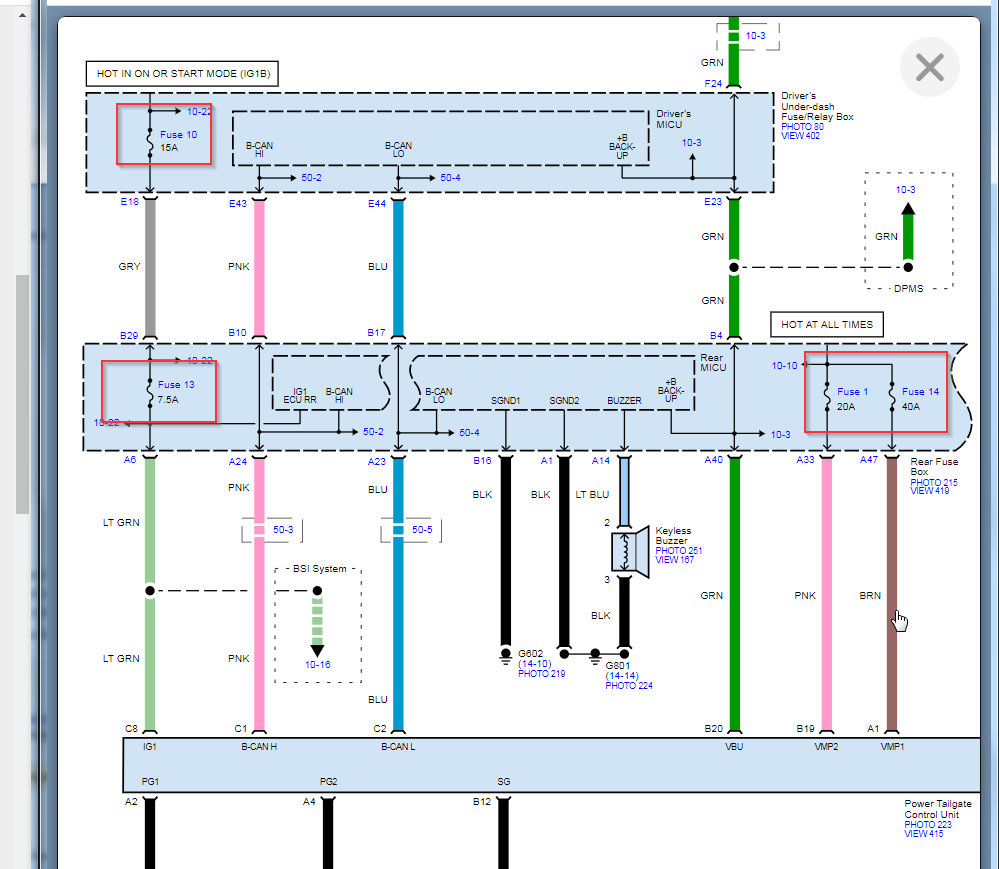

If there are no codes then we are going to have to check fuses as there are 4 involved but not one that directly controls just the door. I included these below as well.
Please let us know what you find with this info and we can go from there. Thanks

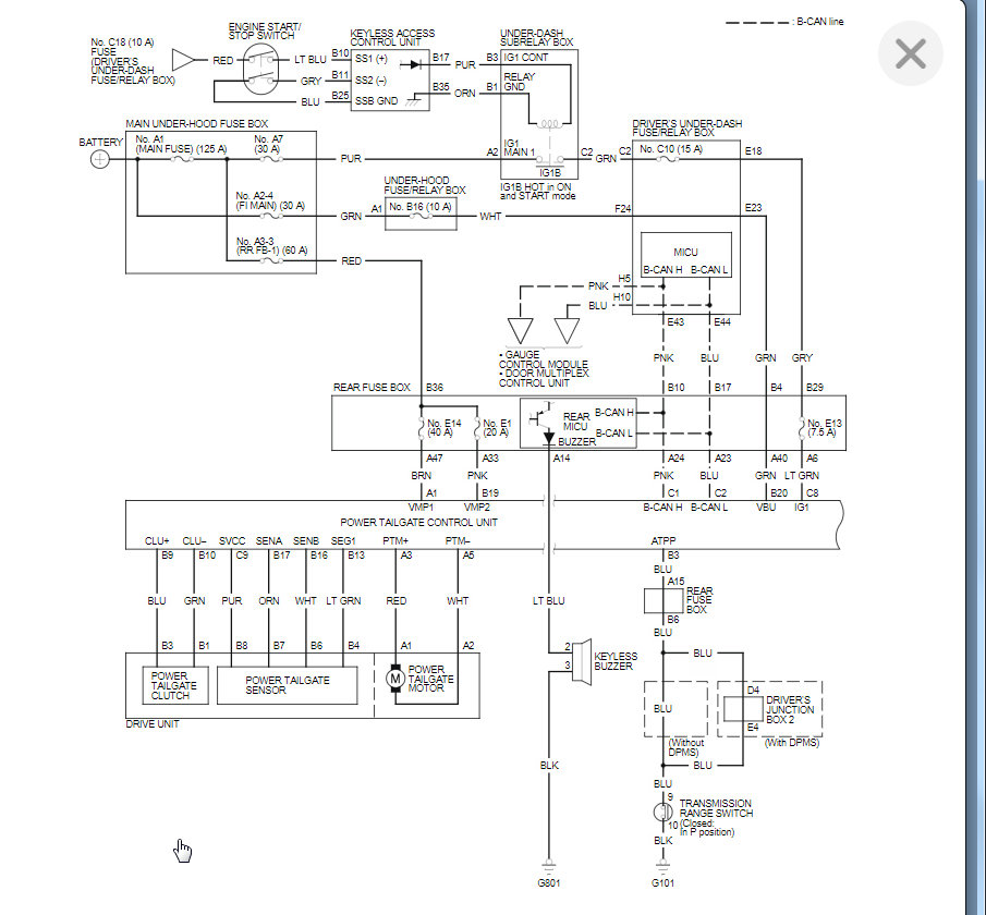

The thing that is concerning me is that it is not beeping at all. That means the control unit is not getting the signal that the button is being pressed. So we need to go the rear fuse box and check the fuses for this system which as shown below. They are E14, E1 and E13.
Once we know they are ok we are going to have to test the voltage coming out of the Power Tailgate control unit just to make sure it is operating but I suspect we will find the control unit is the issue.
Let me know if you have questions on this.
