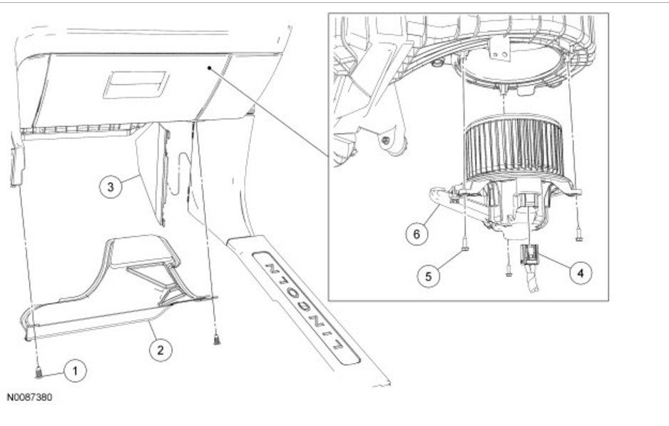

My wife was driving our vehicle and smelled burning rubber and then the blower stopped. I checked and it is not working on any speed.
The rear vents are blowing okay. Also, there seems to be a really loud fan kicking on in the engine compartment occasionally since that happened. not sure if that is related.
What is the best way to determine if it is a relay, resistor, fuse, motor or something else?
Thank you for your help!

It sounds like the blower motor shorted out.
Here is a guide and some diagrams that will show you how to test the motor and how to replace it:
https://www.2carpros.com/articles/blower-fan-motor-works-on-high-speed-only
Here is the location on your car (below).
Please let us know what happens so it will help others.
