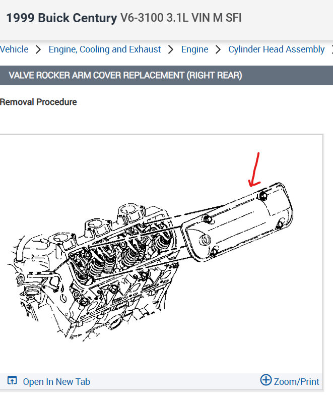

That is good to hear, it sounds like you have a valve cover leak and oil is running down onto the exhaust manifold. I would check under the hood with a flashlight to help confirm the leakage, here is where you want to look, both sides. Check out the images (below). Please upload pictures or videos in your response of any problems so we can see what to help you with.

Definitely not a valve cover gasket leak. I know the smell of leaking oil burning on an exhaust manifold. The only oil leak this car has is internal. It starts around 2-3k after an oil change. When it gets a bit low, I add some 20w50 until I can get around to changing it all. The car is old and runs non-stop for several hours every day. Otherwise, it starts pretty clean and there are no spots under it, even if it sits for days. Every mail route car I've ever owned (that's a lot) has burned oil.

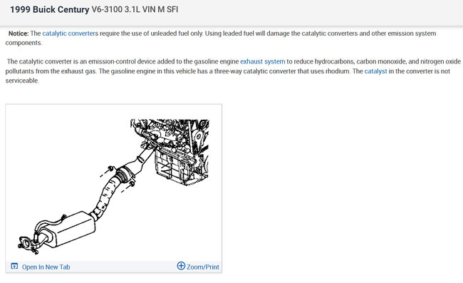

Smells are hard to decipher, could it be coolant you are smelling? Also, can the leak be lower such as the oil filter or oil pressure sender? I have not seen carbon smell in the exhaust. But if this is something you are sure of you can undo the exhaust and inspect the cat inlet. Check out the images (below). Let us know how it goes.
