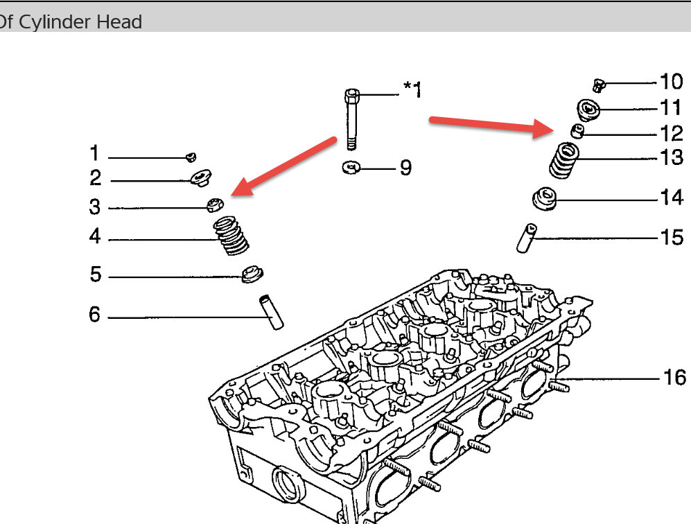

2004 KIA OPTIMA
98,000 MILES
IVETTE RIVERA
It come out white smoke when the oil is low. Took it to two mechanics no leak, change PCV valve and did a tune up. Do not know what to do? Any ideas please?

if it is still burning oil then it may be valve seals bad, but keep in mind how often you need to add oil if using one quart at 1000-1500 miles that is normal. See picture for location.

it only has 98 ,000 on it and i have no idea how much oil you are burning, if it is in the range that I posted previously drive it.

I could drive without any problems . My concerns is that the oil evaporated so fast. I would change the seals of the valves. Hopefully that would fixed the problem. I love my car so much, I have for nine years. Thanks for your input.

Oil does not evaporate so it must be burnt or leaked out.
Here are two guides that can help you see what the problem is.
