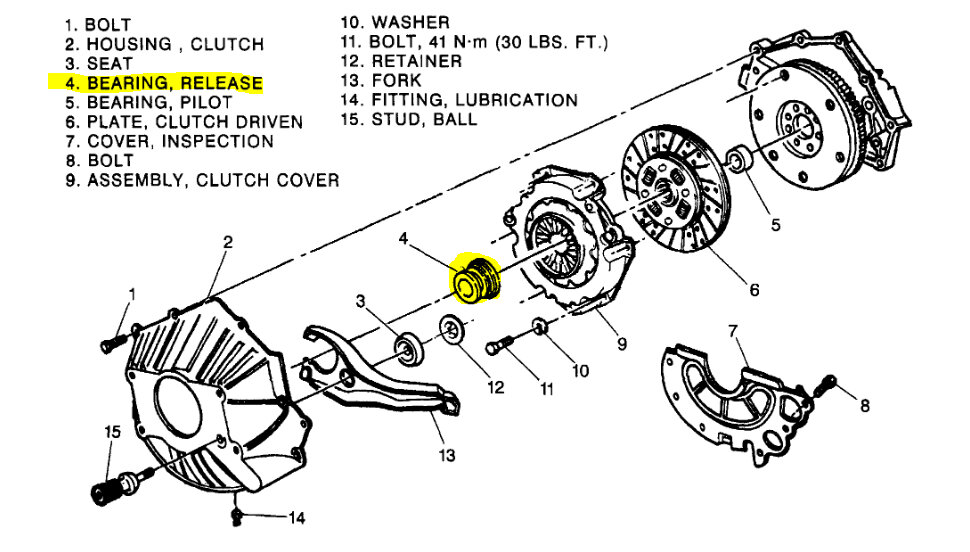

The throw-out bearing is against the clutch pressure plate all the time and needs to be moved back 5/8 of an inch, what do I need to do to move it back?
1995 CHEVROLET 1500
300,000 MILES • 5.7L • V8 • 2WD • MANUAL
NEWJONES1962
Put brand new clutch and pressure plate and Clutch fork pivot ball throw out bearing is against pressure plate all the time. what can I do to move it back?

The hydraulic clutch system locates the clutch pedal height and provides automatic clutch adjustment. No adjustment of clutch linkage or pedal position is possible. So, either we have a faulty part or something isn't together properly.
Are you sure the new release fork isn't bent or the slave cylinder is seated properly?
