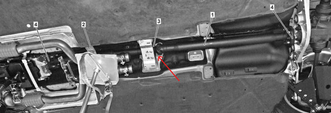

I have seen the driveshaft center support go out on these cars, also are there any body codes? Did the shop un the body codes to see if any were present?
Here is the location of the driveline center support, I would grasp the shaft and check for play at the support. Check out the images (below). Please let me know.

Wouldn't the drive shaft make a constant noise or sound. The sound from my car is barely audible and in patterns of 2 or 3 thumps from the vacinity of the steering wheel. Also, it doesn't every day or every time the car is driven. There is no rattle or banging or grinding. There is no code, but the thumps are connected to one of the warnings systems as an alert on other models. The thumps are patterns of 2 or 3 which represents an intended warning signal.

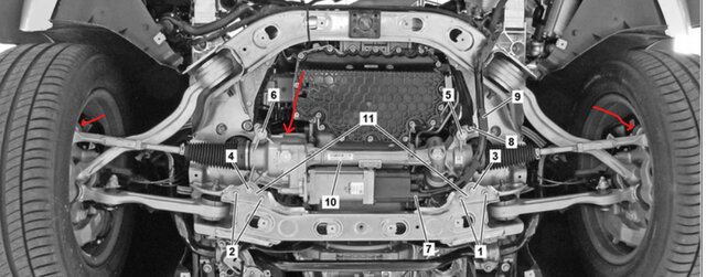

Gotcha, yep this can be the electric steering going bad, I would run a CAN scan to see if any codes are present that point in that direction.

I would check the tie rod ends as well, here is the location of the steering gear. Check out the images below
