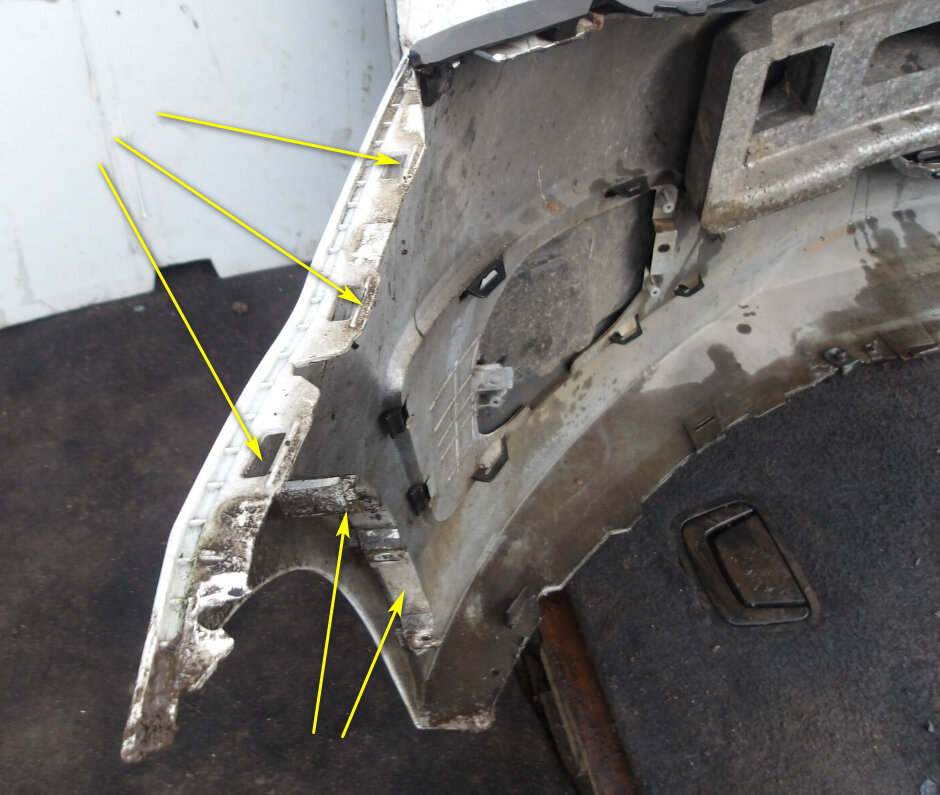

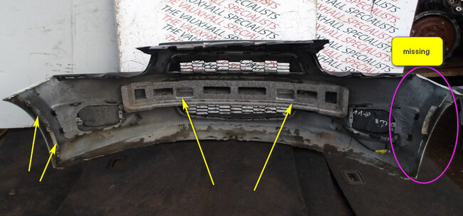

I need to get a re placement front bumper for the Barina and I'm looking for images of the passenger and drivers side mounts/clips that are part of the bumper to make sure that the 2nd hand one isn't missing any.

Your Holden Barina TM is based on the Chevrolet Aveo/Sonic T300.
A good video on how to remove bumper:
https://youtu.be/BSpcAGofna0?si=ZMtR7DU0zcnNjz5D
Below are pictures of a Chevrolet Sonic front bumper.
Accident damaged, right-side mount for wheel arch liner missing.
I could not find any usable pictures for a Holden Barina TM.
Perhaps you could post some clear pictures of your vehicle's front bumper once removed.
Cheers, Boris

I followed this today and was able to remove and install the replacement bumper I had bought.
