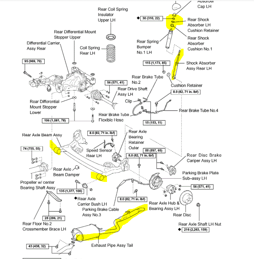

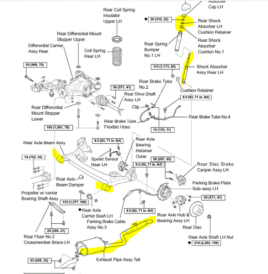

When driving, every now and then, feel a bump in the rear like when someone bumps you in the back or you have heavy luggage or equipment in the back and moves around and bumps.

Since you mentioned it seems like something is moving around, the first thing I'm going to suggest is to check the rear suspension under the vehicle. Check for anything that is loose or damaged. Inspect bushings as well. Also, see if you are able to move the exhaust around that wound indicate a bad rubber mount.
I attached a pic below showing the rear of the vehicle. Check the things I highlighted and let me know what you find.
See pic below.

In the pic you sent that's below, where is the rear suspension?

The pic is showing what is called an exploded view of the rear suspension. It identifies the components as seen when they are apart.

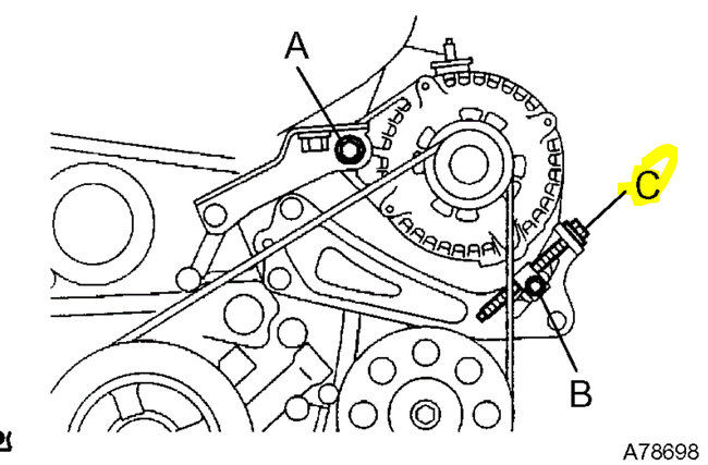

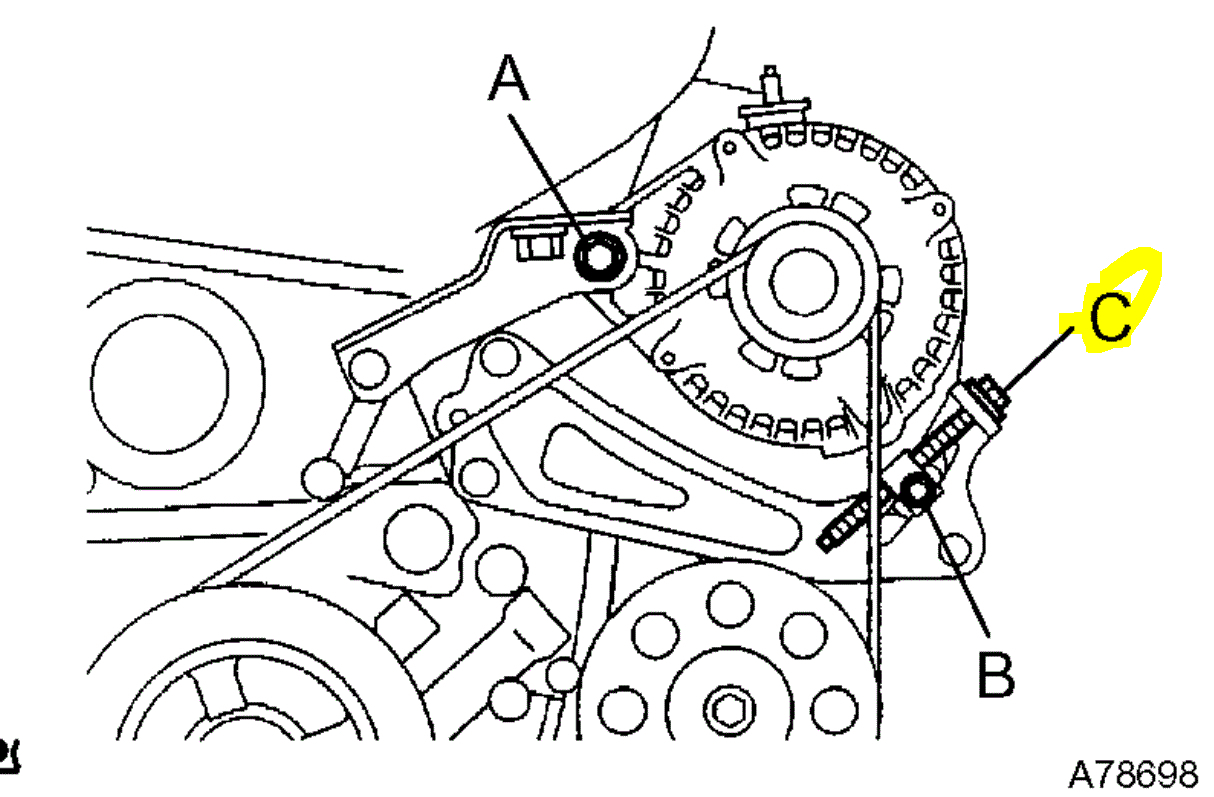

As far as the belt noise, yes if the belt has become loose. If the sound goes away after startup, the first thing I would check is the alternator belt. When the car first starts, there is a quick heavier load placed on it.
If you check it and find it's loose, it should be tightened. If you look at the pic below, you will need to loosen bolts A and B first. Then, tighten bolt C which is the adjuster until the belt is tight.
Let me know what I can do to help.

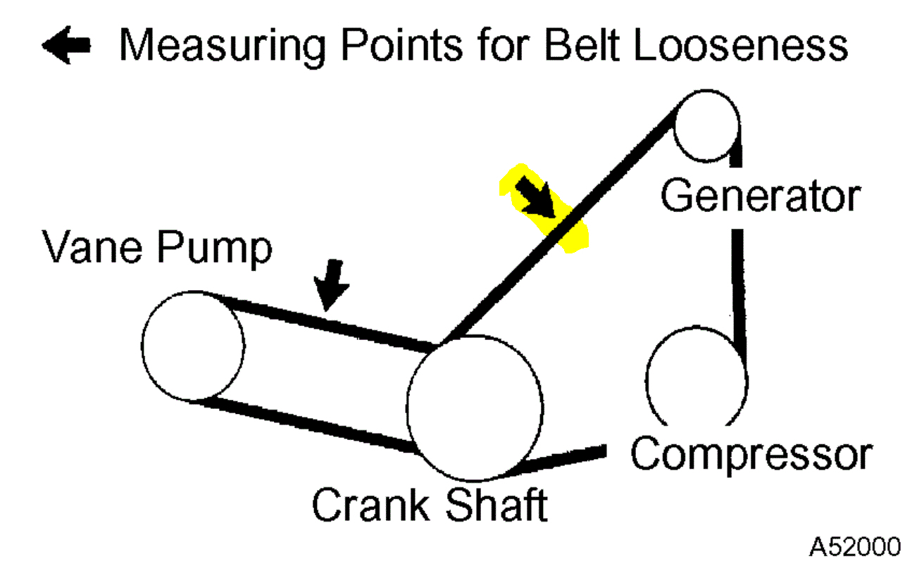

I tightened all the bolts since I had to replace and install a new drive(alternator) belt. I felt the belt tight. How do I determine if the belt is as tight as it should be?

If you look at the pic below, I highlighted where to test. You should be able to move the belt approximately 3/4" (deflection) up and down.
Let me know if this helps.
See pic below.
