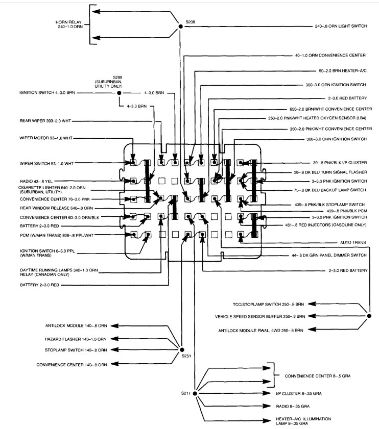

I have looked everywhere for a bulkhead pin out diagram. I have a 1994 truck but motor and transmission and wiring harness from a 1995 and the bulkhead connectors are different I need to convert the 1995 to the 1994 connector but cannot find the pin out diagram TYA.

I need the pinout diagram for the 1994.

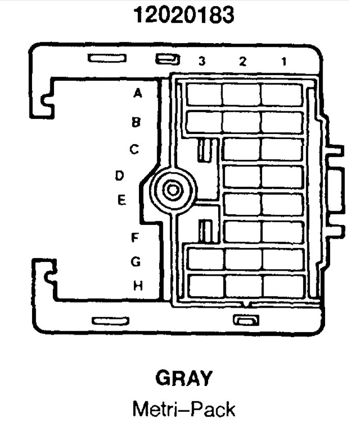

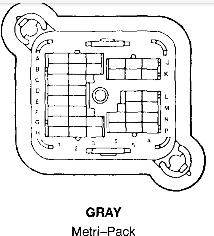

They really don't give that information, here is the bulkhead connector but I don't see the wiring for it. But I did find wiring diagrams for the fuse panel. Check out the images (below).
Aug 8, 2025 at 5:02 AM
