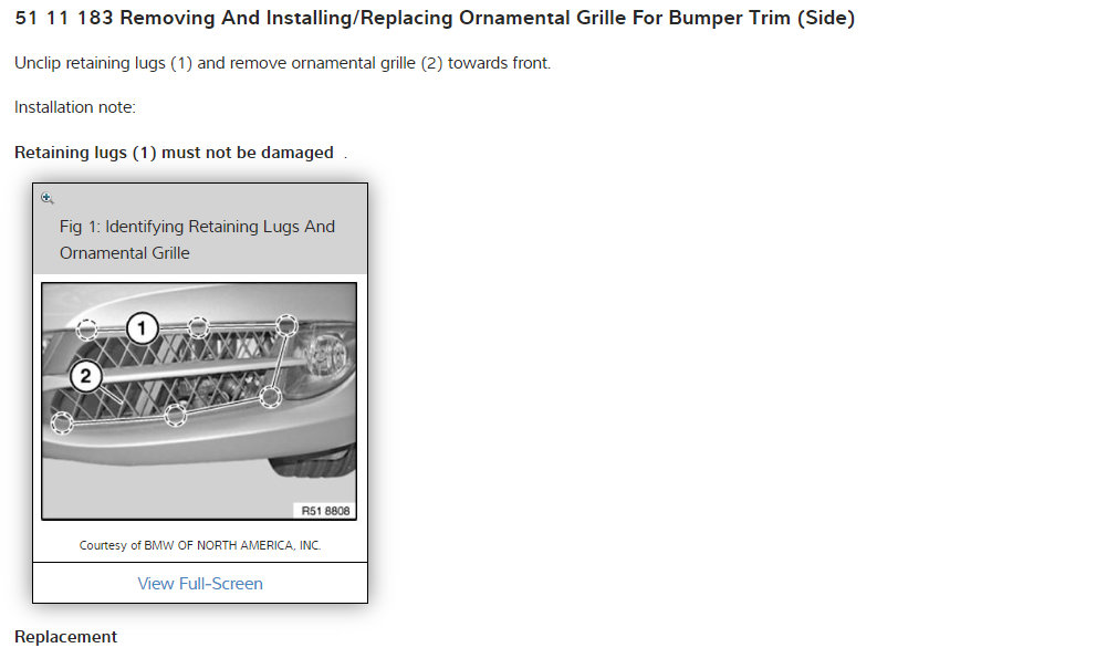

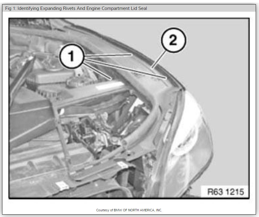

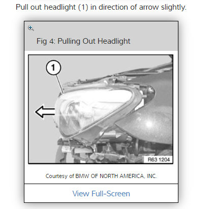

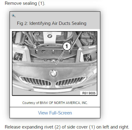

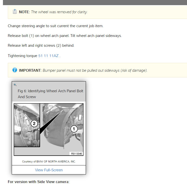

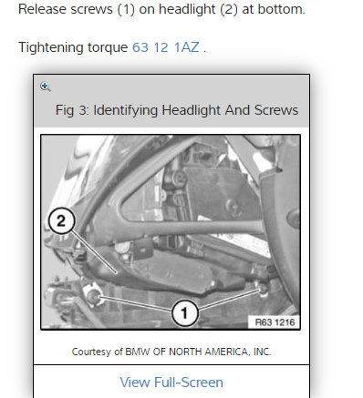

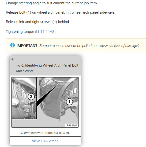

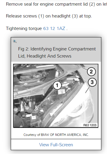

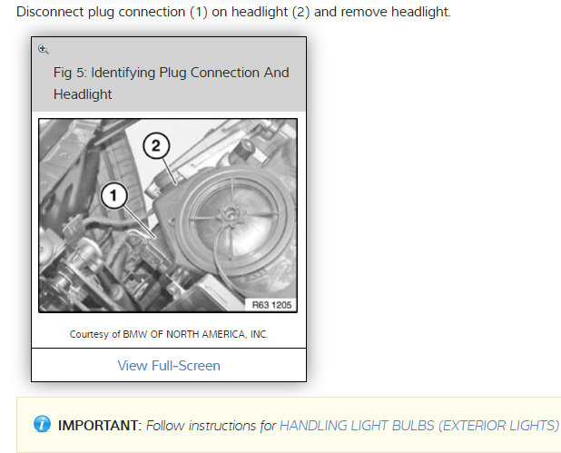

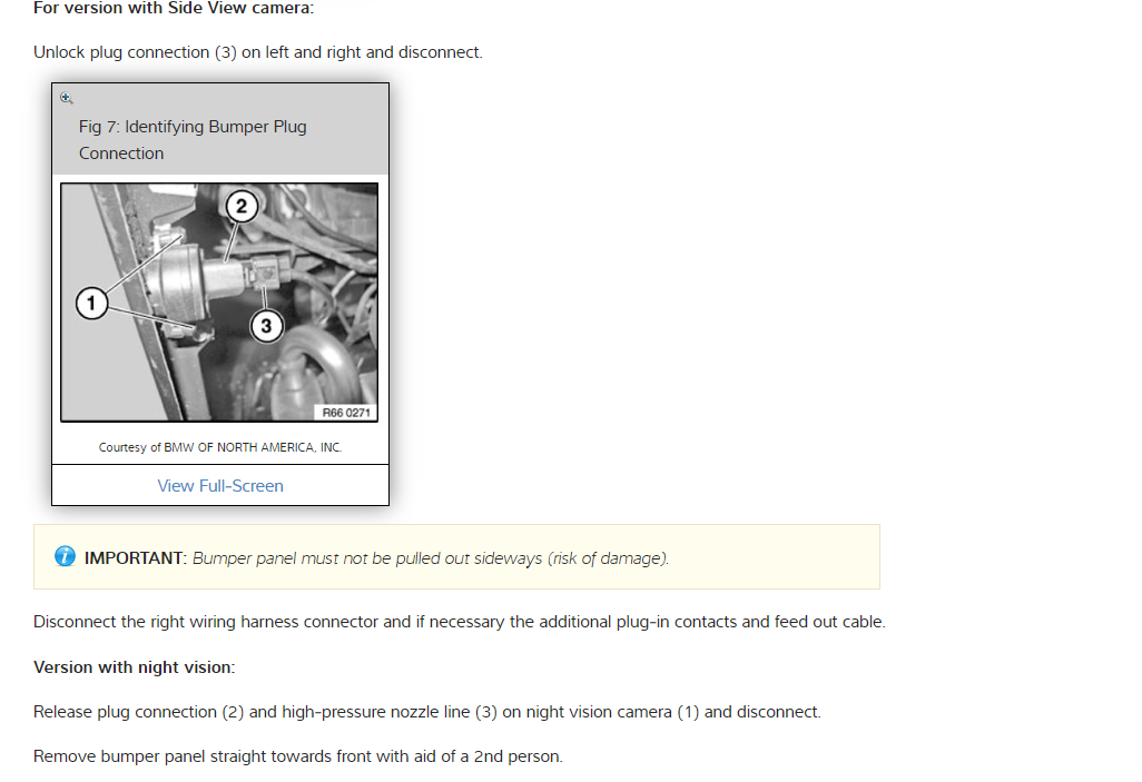

How can i change the bulbs on the driver side and also if needed how can i replace the headlight?
Feb 18, 2020 at 1:07 AM
PORTAFISHING
  • 37 POSTS

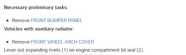

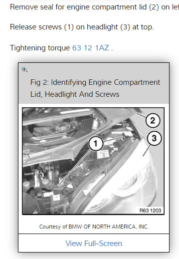

Here are the instructions for the front headlight assembly removal.I wasn't sure what other lights you needed if you need more please let me know. i hope this is helpful.

So bumper must come out?
Feb 18, 2020 at 4:35 AM
PORTAFISHING
  • 37 POSTS

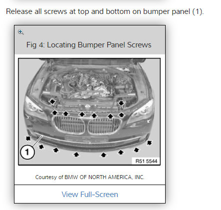

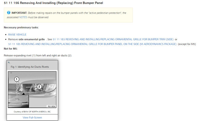

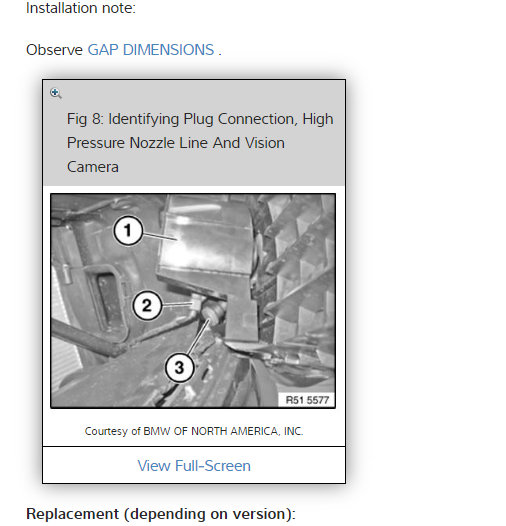

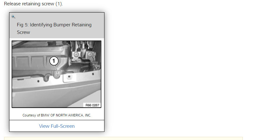

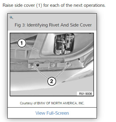

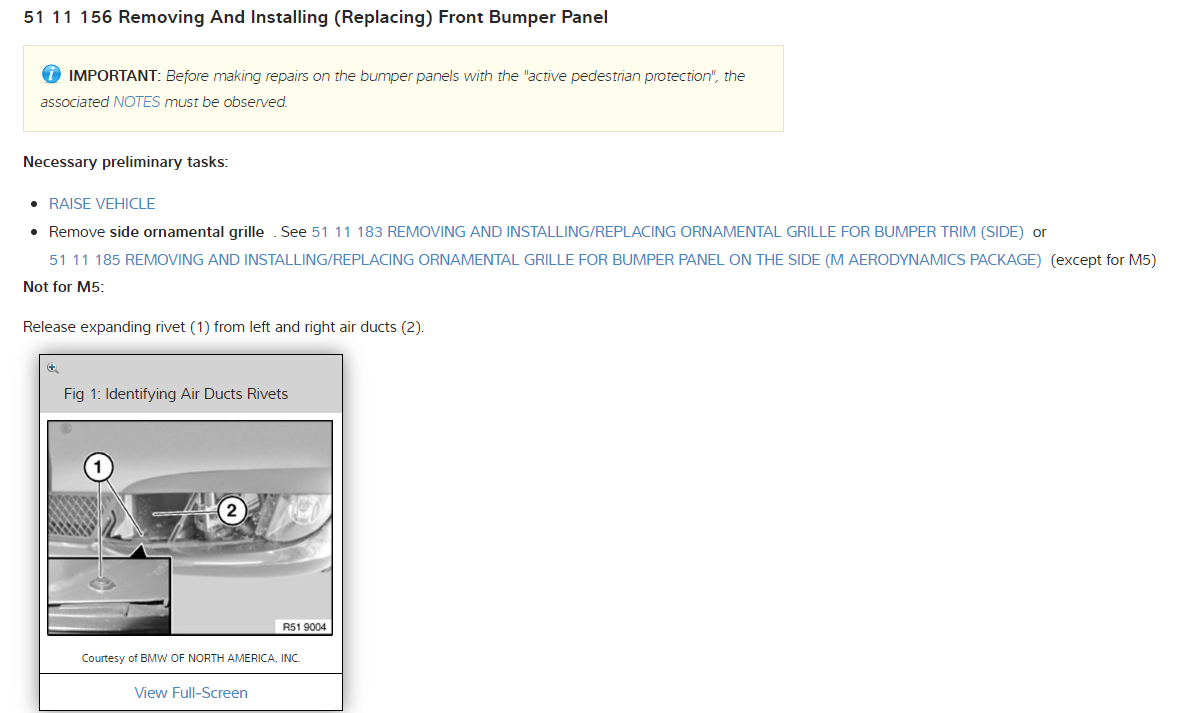

It talks like the bumper had to come out and the grille. you might look at it. If so I can send you instructions on that also.
Feb 18, 2020 at 4:54 AM
NASER NASER
  • 836 POSTS
Yes it seems like it. please send instructions.
Feb 18, 2020 at 5:11 AM
PORTAFISHING
  • 37 POSTS

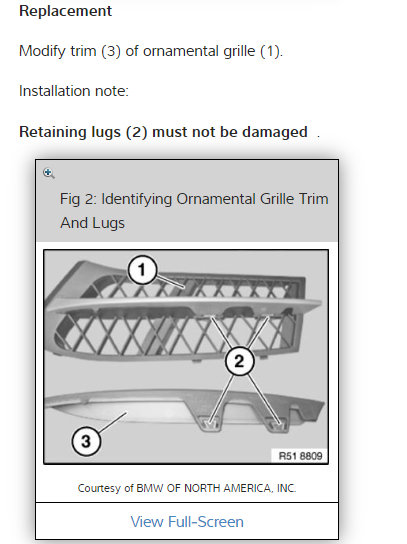

Here are grille and bumper removal instructions, grille first. Let me know how it goes and if i can be of an more assistance.
