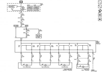

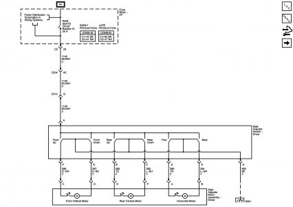

I bough a Terraza Power Seats on ebay, i need help to conect this seats in a chevy express van.
Tanks
Sep 15, 2007 at 7:34 PM
DENNYP
  • 1,824 POSTS
here are some diagrams. not sure if they will help.
