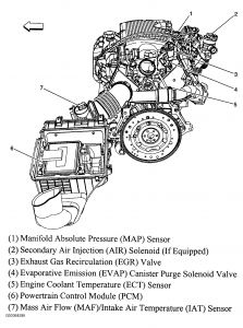

No TPS has TAC system cabeless throttle. One thing that can cut engine power is the MAF get some MAF cleaner and clean. see diagram
https://images.2carpros.com/forum/automotive_pictures/198357_Graphic_544.jpg
Believe getting to point where needs to be diagnosed by a diagnostic scann tool such as MODIS

FYI, Did install plugs, air filter was not as good as I thought so changed, this helped problem maybe 30%, took van to local independent shop, they cleaned MAF & TB, also did fuel induction service. Don't know if problem was corrected w/o induction service or not. Only a few dollars more and I wanted the problem fixed and it is. Thanks for you help. Kenny
