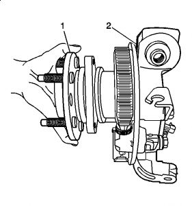

I was told that I need to repair the wheel Bearing front and rear and the rear knuckle. What is the knuckle? Why is connected. Any ideas of how to repair.
Oct 24, 2009 at 7:50 AM
DOCFIXIT
  • 18,828 POSTS
See diagram #1 bearing #2 knuckle

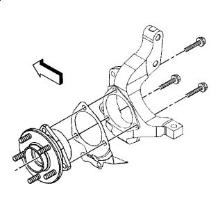

Replacement is rather involved and requires several special tools and will need aligned. Front bearing remove wheel caliper, rotor , speed ring and wiring then unbolt. see diagram
