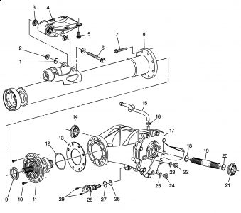

2005 Buick Terraza All Wheel Drive Automatic
all wheel drive disabled light stays on. Fuse is good. Only front wheels drive currently, no rear wheel drive. What next?

There is a common failure in the AWD system. It is the differential clutch pump actuator check valve. This is the small sensor that is mounted in the rear end. It will have a couple of wires going to it. It is #28 in the picture.
