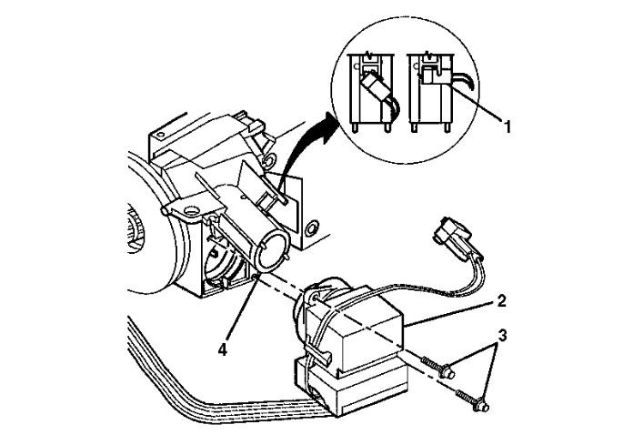

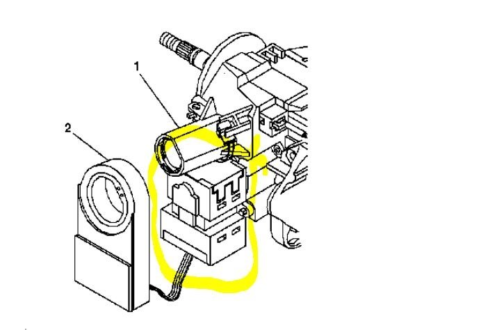

What was the actual fuel pressure when you checked the fuel pump?
Also, did anyone check the ignition switch? That was common for shutting off.

Do not assume anything. The ignition switch could be opening internally on just one wire that powers the PCM.
I would call the dealer and give the service department your VIN number and see if there are any open recalls. There were recalls on the ignition switch but it was restricted to certain VIN numbers.

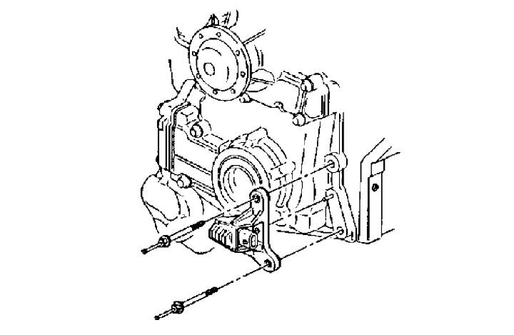

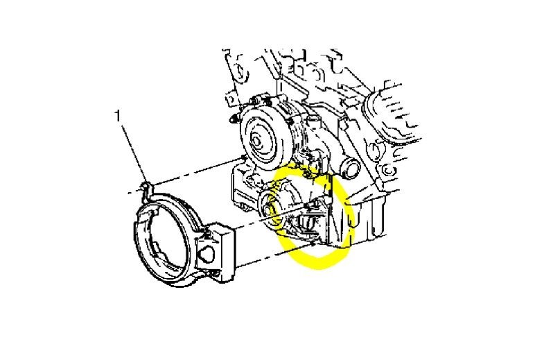

The other possible issue is the crank sensor.
CRANKSHAFT POSITION (CKP) SENSOR REPLACEMENT
REMOVAL PROCEDURE
1. Disconnect the negative battery cable.
2. Raise and support the vehicle. Refer to Vehicle Lifting.
3. Remove the crankshaft harmonic balancer.
4. Disconnect the crankshaft position (CKP) sensor electrical connector.
5. Remove the CKP sensor shield (1). DO NOT use a pry bar.
6. Remove the CKP sensor studs.
7. Remove the CKP sensor.

I understand. A crank sensor can be doing this without throwing a code.
You need to monitor live data to see if the RPM falls out when the event happens.

The fact the RPM is dropping out that quickly tells me it is related to the crank sensor.
