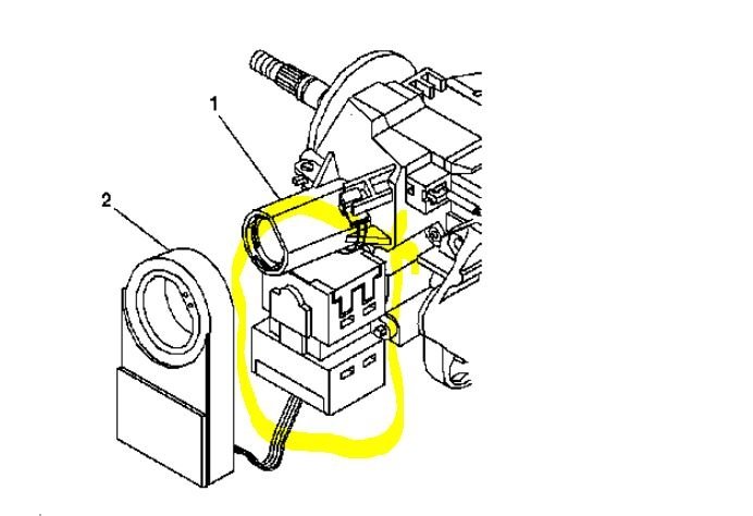

What was the actual fuel pressure when you checked the fuel pump?
Also, did anyone check the ignition switch? That was common for shutting off.
https://www.2carpros.com/articles/engine-stalls
Jun 5, 2019 at 5:14 PM
RJNAGEL
  • 10 POSTS
60 PSI is what the fuel pressure was when testing while running. When revving engine, it went down a tick, but not much. We were told it needed to be 55-65 PSI.
There is no issues when starting, and dash lights do not "flash on/off" so figured it was not ignition switch like reviews I read said it would do if that was the issue.
Jun 5, 2019 at 5:20 PM

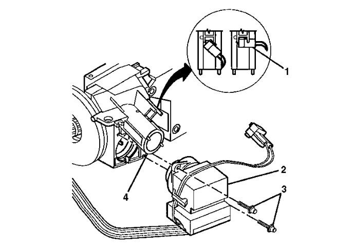

Do not assume anything. The ignition switch could be opening internally on just one wire that powers the PCM.
I would call the dealer and give the service department your VIN number and see if there are any open recalls. There were recalls on the ignition switch but it was restricted to certain VIN numbers.

We replaced the ignition switch on the 8th of June and it had been working perfectly. until this morning when it stalled again. So apparently that latest part did not fix the stalling issue. Luckily, my son was pulling into a parking lot at work when it stalled so he was off the highway.
Know of anything else we can attempt as we are stumped!

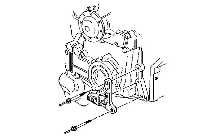

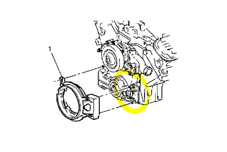

The other possible issue is the crank sensor.
CRANKSHAFT POSITION (CKP) SENSOR REPLACEMENT
REMOVAL PROCEDURE
1. Disconnect the negative battery cable.
2. Raise and support the vehicle. Refer to Vehicle Lifting.
3. Remove the crankshaft harmonic balancer.
4. Disconnect the crankshaft position (CKP) sensor electrical connector.
5. Remove the CKP sensor shield (1). DO NOT use a pry bar.
6. Remove the CKP sensor studs.
7. Remove the CKP sensor.

See above at the start of this thread. That has already been replaced, back in February. Stalled immediately following the test drive after replacing. Actually, we replaced it twice as the first one was a bad part, so had to take it all apart and do it again! Easier the second time around at least!

The fact the RPM is dropping out that quickly tells me it is related to the crank sensor.
