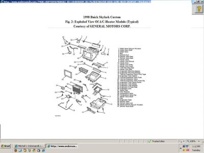

I have to replace the heater core on my 98 Buick Skylark and before I go in and start tearing my dash off, I wanted to ask around to find out exactly where the heater cor is located and how to get to it with minimal fuss. Thanks alot

Heater core is under the dash on the passenger side. If you look under the hood on the firewall, you will see where the heater hoses attach to the core. The actual core is on the back side under the dash
