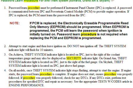

How do you reset the security settings?

https://images.2carpros.com/forum/automotive_pictures/406719_security_relearn_1.jpg
