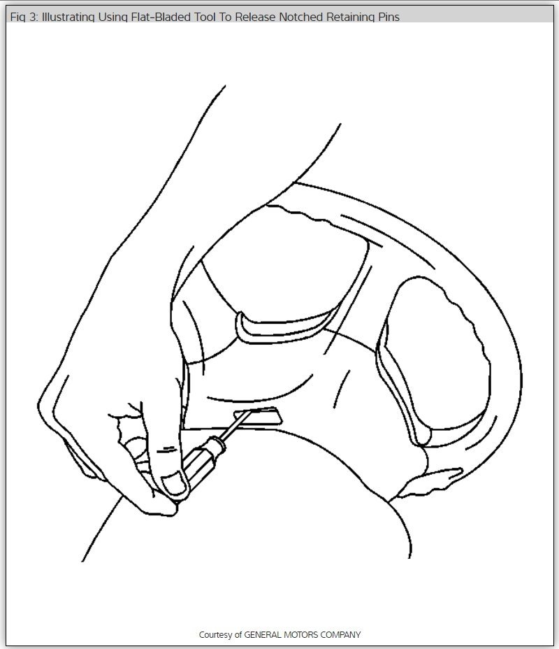

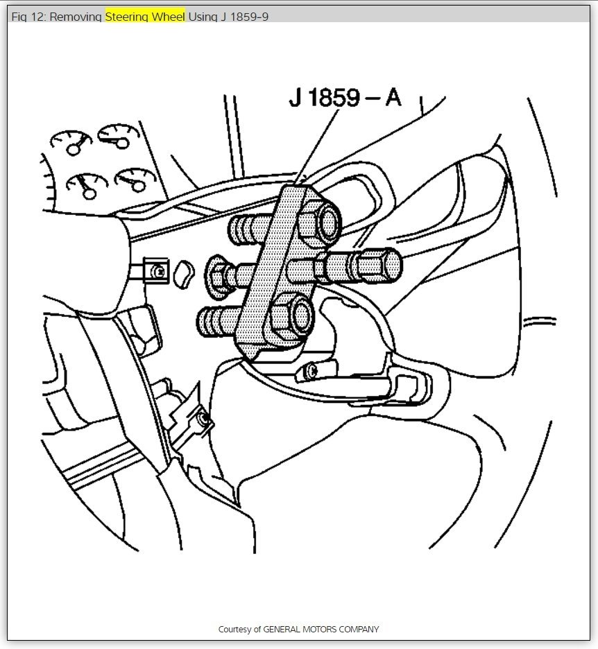

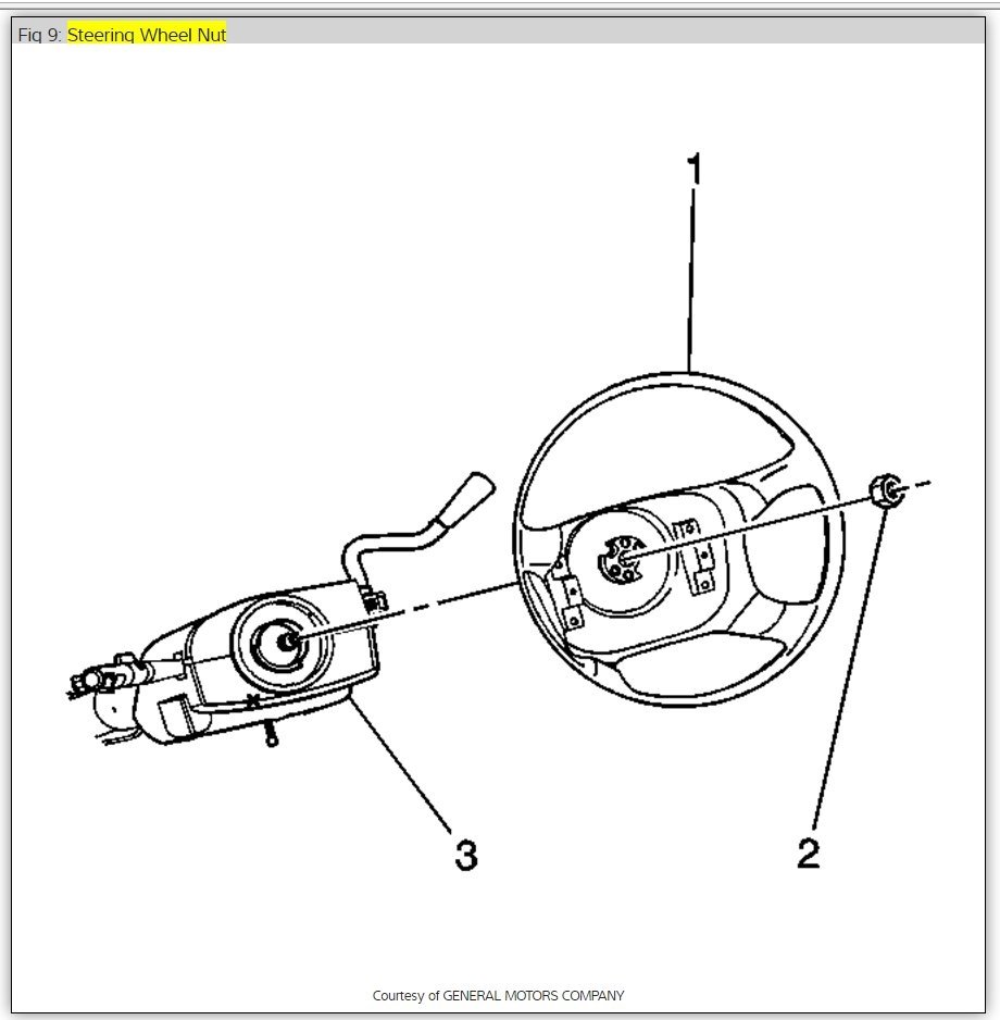

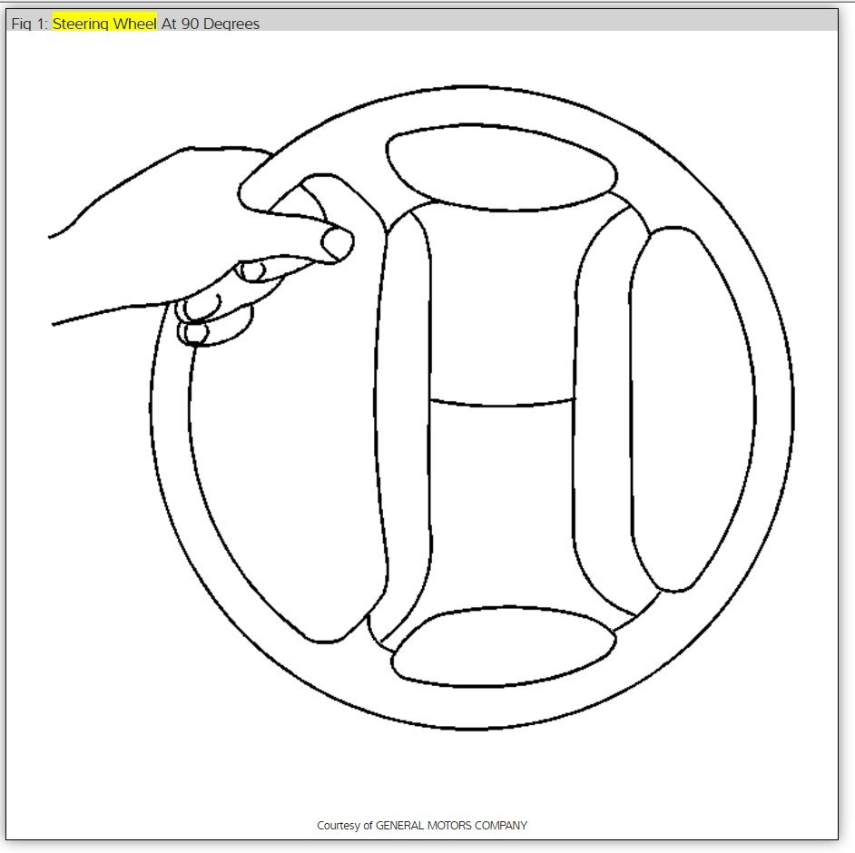

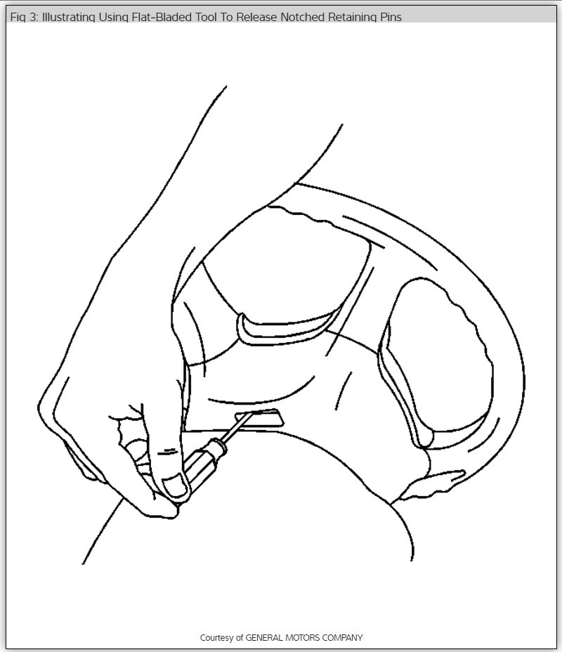

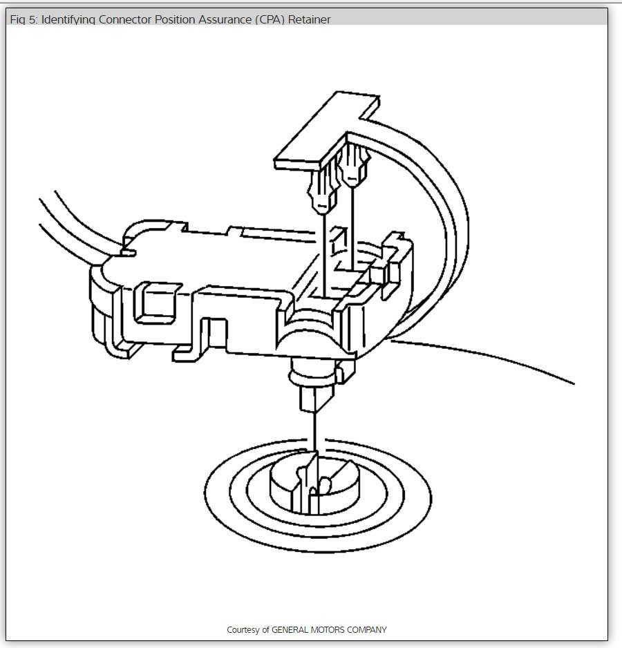

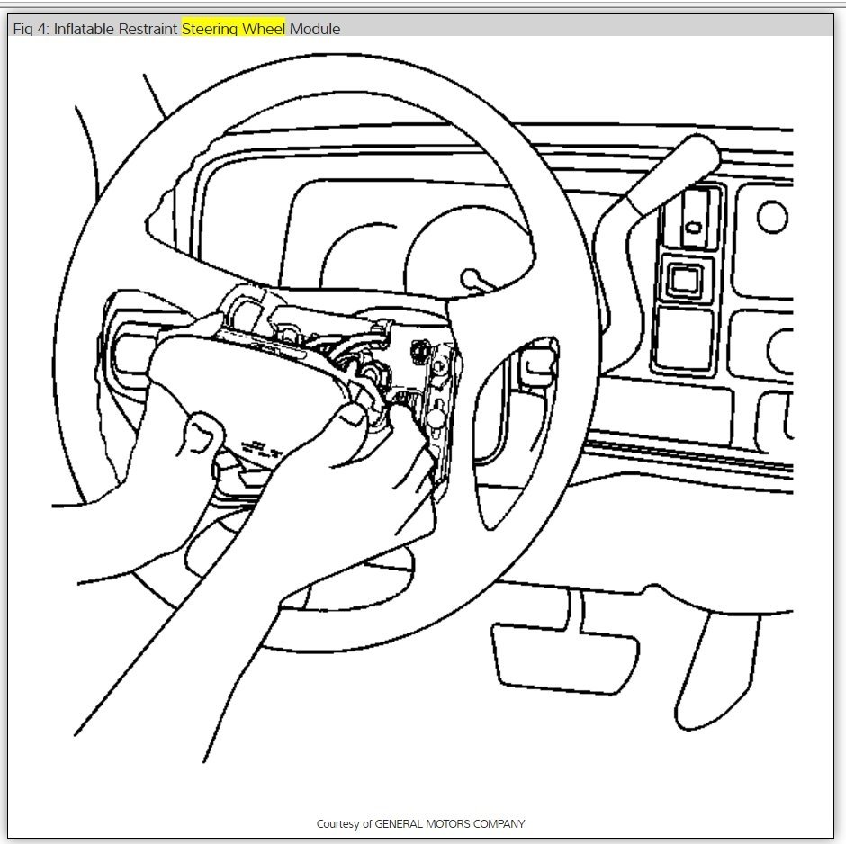

The headlamp switch on my Skylark quit working yesterday. Fortunately this happened when I turned the headlights off, but now I need to replace it. Is this a fairly simple job? If so, can you tell me how to make this repair? I have looked in the Chilton manual but it shows the switch on the steering column. The switch in my car is on the left side of the instrument panel.
Apr 12, 2010 at 3:15 AM
BLUELIGHTNIN6
  • 16,542 POSTS

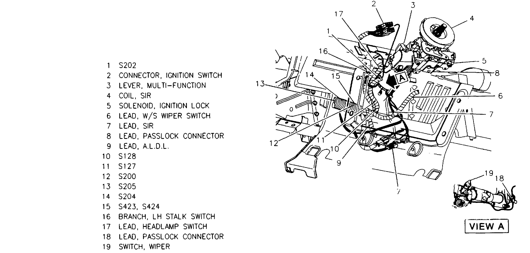

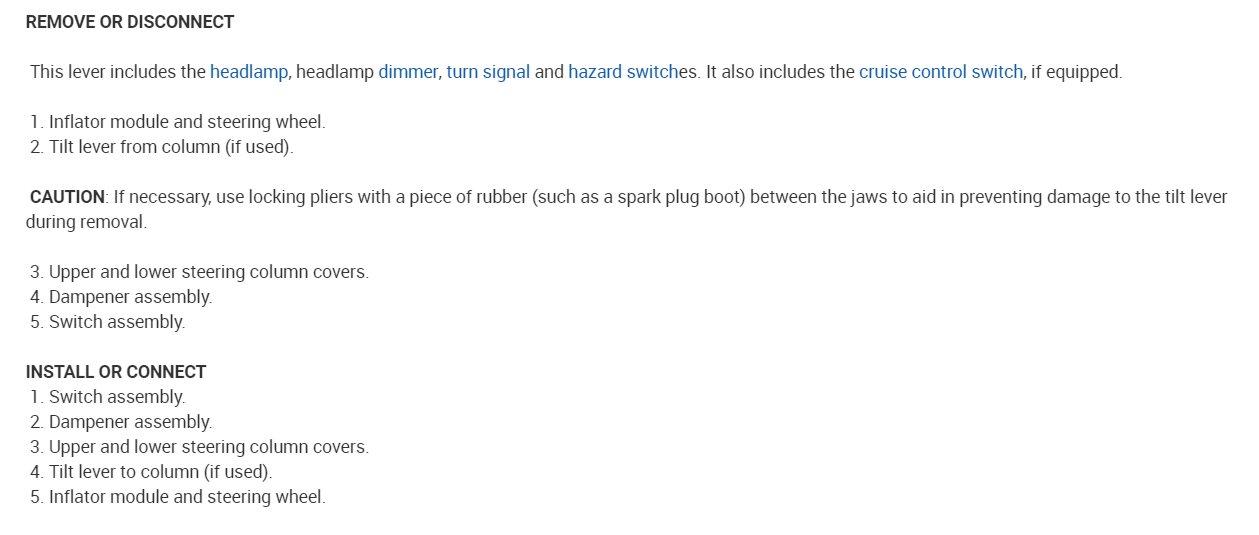

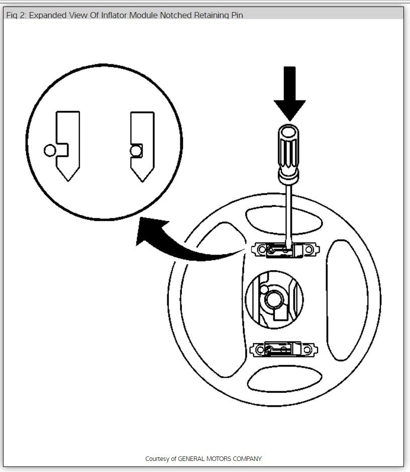

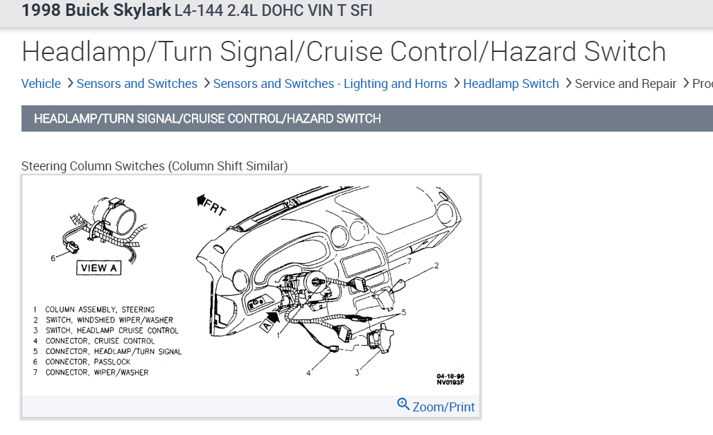

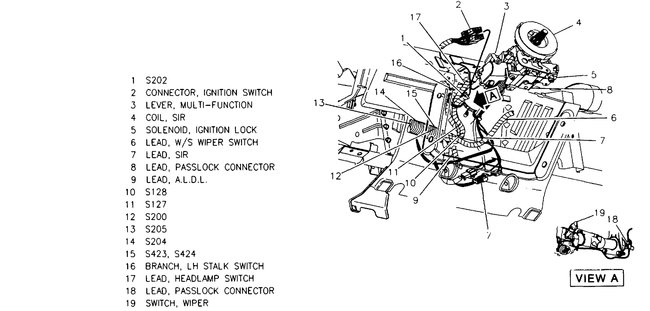

the 1998 skylarks used a multi function switch which operated the headlights, turn signals, cruise control and hazard lights all in one, on the steering column. Here are diagrams below that will help show you how to do the job. You while need to remove the steering wheel.
