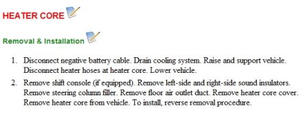

1998 Buick Skylark 6 cyl Front Wheel Drive Automatic
How to remove heater core with air conditioner
May 17, 2010 at 5:15 AM
BLUELIGHTNIN6
Experienced Mechanic
16,542 POSTS
May 17, 2010 at 6:40 AM
