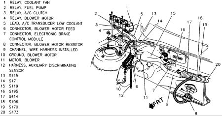

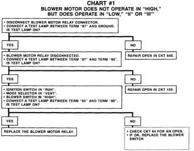

I have a 98 Buick Skylark and the High setting on the heater/Air conditioner siwthc doesn't work. The other settings work, but when I put it on high, there is nothing and it causes my battery light to come on. Any thoughts on how to fix that? or where to find the cheapest parts for this car?

Hello - I have attached the troubleshooting chart for this. I am not sure if you want to go through all of the checks. It eventually points to the relay. That would be my guess. It is number 4 in the pic, third relay from the passenger side. Maybe $15-$20 at Auto Zone or O'Reilly's
