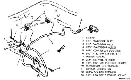

where is the freon valve located on a 1997 buick skylark?
Jul 15, 2010 at 12:43 PM
  • 75,992 POSTS
The low side pressure valve is located @ #13-see diagram below: Service Port HVAC A/C Hose Routing And Service Port Locations - 3.1L
