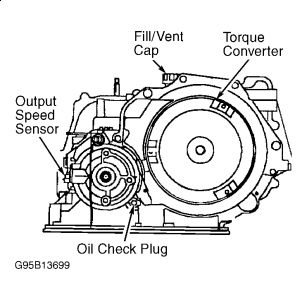

where do you put the transmission fluid at in a 96 buick skylark?

Has no filler tube must be checked by plug on trans. see diagram

Hello, if there is a transaxle dipstick tube, you add the fluid there, if needed. You use a funnel with a neck that will fit in the dipstick tube.
