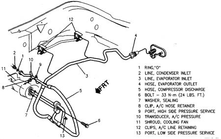

Air Conditioning problem
1995 Buick Skylark 6 cyl Two Wheel Drive Automatic
Where are the AC ports on this car and which one do I charge
Aug 7, 2010 at 9:16 AM
  • 75,992 POSTS
Charge A/C at the low side pressure service port located @ #13-see diagram below: Locations A/C Hose Routing And Service Port Locations - 3.1L 6cyl.
https://images.2carpros.com/forum/automotive_pictures/12900_sp_22.jpg
Lines are connected between Condenser, Evaporator, and Compressor. https://www.2carpros.com/kpages/auto_repair_manuals_alldata.htm
