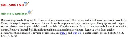

how do i change a serpentine belt for 1995 buick skylark?

My database shows this for the 3.8.
https://images.2carpros.com/forum/automotive_pictures/170934_skylark_belt_removal_1.jpg
