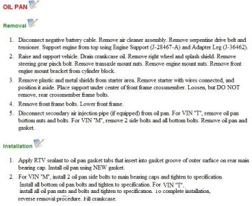

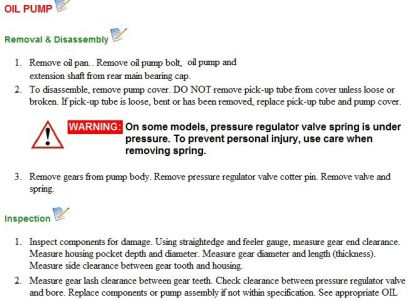

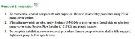

How do I take out an oil pump and oil pan gasket and then install new ones?

BLUELIGHTNIN6
MECHANIC
16,542 POSTS
SPONSORED LINKS
Wednesday, April 21st, 2010 AT 9:15 PM
