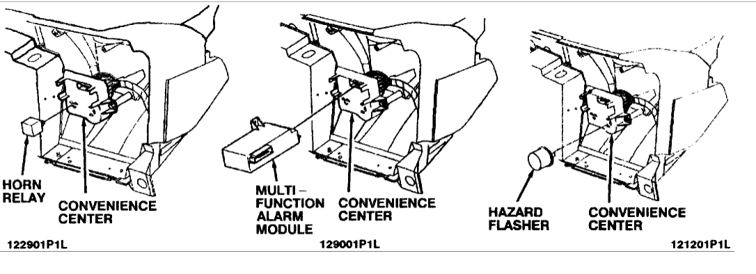

I need the location of the horn relay on my buick

the horn relay is in the convenience center on the drivers side under the dash Here is a guide to help you test it.

Thanks I will test the relay tonight to see if that was the problem.

Ok, Check under the dash near the steering column. There should be a bunch of fuses and relays there then. Please let me know.

It was the problem thanks for helping me I feel safe now that I have a horn. I love this site BTW.
