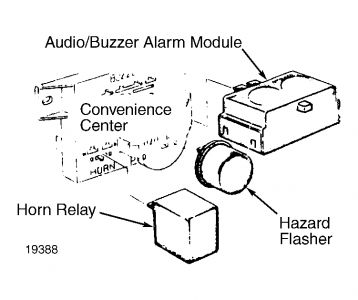

I need to know where is the horn relay located on my 1982 buick skylark? It`s not in or around the fuse box. It`s not behind the glove box. And I can`t find it in the engine bay either.

Hi Supposed to be in Convenience Center
https://images.2carpros.com/forum/automotive_pictures/198357_Graphic_456.jpg
Have you checked for power to horns? Does horn button ground? Let me know
