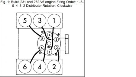

I have a 231 Buick V-6 in a 1986 toyota pick up. After I was done doing a tune up on the truck I noticed the turck was running rough almost sounding like the cylinders werent firing correctly. There might be a possible chance mixed around the spark plug wires, on the down side i dont get the manual until sometime next week. What is the spark plug wire order? or do you think this is the problem ?

What I looked at was 231 buick century, but it is a 231. I can't guarantee the picture. It is from an old database.
https://images.2carpros.com/forum/automotive_pictures/170934_buick_century_firing_order_1.jpg
