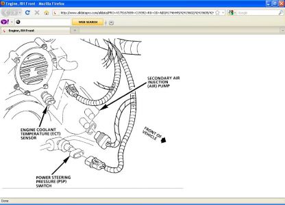

Engine Cooling problem
1994 Buick Roadmaster V8 Two Wheel Drive Automatic
where is it located???

https://images.2carpros.com/forum/automotive_pictures/416332_1994_buick_road_master_cts_1.jpg
If your talking about the coolant temp sensor then here it is.
Aug 6, 2010 at 5:41 PM
HOONU
Is this the one that activates the radiator fans?oOr is it the one that is connected to the temp. gauge? I need to get my electric fans running.It's not the motors,fuses or relays.Thanx for your reply!
Aug 6, 2010 at 5:55 PM
SATURNTECH9
  • 30,869 POSTS
That's the one that goes to the pcm so yes that would be the one that turn's the fan on.
