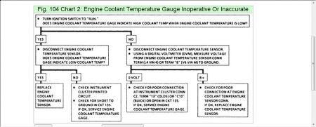

I just recently purchased this 94 roadmaster wagon from an estate sale and absolutely love the car. However, the only thing not working is the temp guage. When I turn the ignition key it pegs over to the far right and goes back down to the far left and remains there. The car doesn't run hot either. I've done the following...checked the fuses and replaced the temp sensor at the front of the engine, just behind the fan. Any advice on where I might go from here? Thank you for your input.
