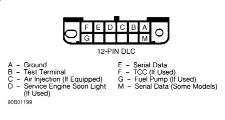

I have a bosch computer in my 94 buick roadmaster
do i need a scanner to run a diagnostic .
it wont run codes from dash
Nov 8, 2009 at 1:06 PM
DOCFIXIT
  • 18,828 POSTS
If 12 pin ALDL then jumper A to B
https://images.2carpros.com/forum/automotive_pictures/198357_Graphic_231.jpg
if 16 pin then need scanner
