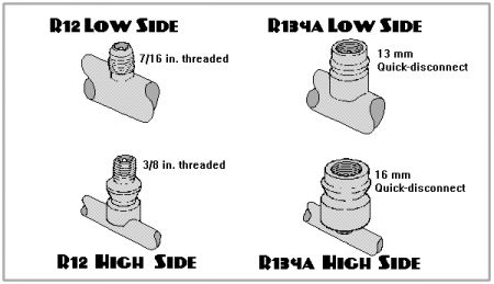

Hi, I was wondering if I can add R134 myself to my A/C and how would I do it??

Find the low side service port ( suction side ) and follow the canister instructions
https://images.2carpros.com/forum/automotive_pictures/12900_ac_service_fittings_9.jpg
