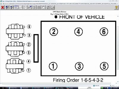

i in doin a tune up on my rivera and i just need the firing order for the wires
Mar 15, 2008 at 8:22 AM
MERLIN2021
  • 17,250 POSTS
3.8...
https://images.2carpros.com/forum/automotive_pictures/62217_Firing_1.jpg
