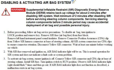

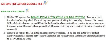

1995 Buick Riviera removeing steering column
1995 BUICK RIVIERA
20,000 MILES • 6 CYL • 2WD • AUTOMATIC
CODGER_62
how does the cover over the air bag get removed air bag or is that part of the air bag. sorry iam broke and unemployed

https://images.2carpros.com/forum/automotive_pictures/261618_Noname_1560.jpg
https://images.2carpros.com/forum/automotive_pictures/261618_Noname2_472.jpg
