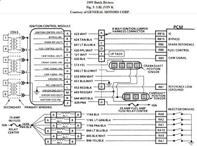

Engine will not crank or turn over was driving great when I replaced the brake line and jacked the car up in air to get under it security light is flashing about one second dont remember if it was doing it before or not cannot hear the fuel pump cross the starter under tha car it did turn over replace the fuel filter kiinda after thought cked the main wire from battery with light it is hot all fuses r good ? 3800 supercharger found one door sensor bad replaced it for alarm in car has antif theft device factory installed lbattery good condition I think it isnt reading the chip in the key for some reason and car battery didnt go down with a barake line change anit theft device should sound horn I assume did lock all doors set off alarm and rearmed it still not reaction from car tried the 10 minute leaving key in ignition trick no responce on that either suggestions

9 . Check ignition module power supply (F/P -IGN fuse and circuit). Repair as necessary. Disconnect fuel injector connector. Turn ignition on. With a test light connected to ground, check for battery voltage on Pink/Black wire of injector harness. If test light is on, go to next step. If test light is off, check INJ fuse. If fuse is blown, repair short to ground and replace fuse. If fuse is okay, check power supply to fuse and circuit between fuse and the injector harness connector.
10 . Turn ignition off. Disconnect ignition module connector. Turn ignition on. Install injector test light to any injector harness connector. Connect test light to battery voltage, and repeatedly touch terminal "D" of ignition module harness connector. See Fig. 3 . Injector test light should flash each time test light is touched to terminal "D". If injector test light flashes, go to step 12).
https://www.2carpros.com/forum/automotive_pictures/192750_ICMWiring95Riviera38Fig03_1.jpg
11 . If injector test light does not flash, check injector drive circuit between PCM and injector harness connector for open or short to voltage. Repair as necessary. If injector drive circuit is okay, check for open, short to ground or short to voltage on fuel control circuit No. 430 (Purple/White wire). If circuit is okay, problem is faulty connection at PCM fuel control terminal or faulty PCM.
12 . Turn ignition off. Using proper jumper adapter from Adaptor Kit(J- 35616), connect a fused jumper wire between ignition module harness connector terminal "N" and battery voltage. Connect a second jumper between ignition module harness connector terminals "M" and ground. Connect DVOM between ignition module harness connector terminal "H" and battery voltage. Observe voltmeter while cranking engine. Voltmeter should read about 1 -3 volts.
13 . If voltage is high, check circuit No. 646 for open or short to ground. If circuit No. 646 is okay, replace faulty crank sensor. If voltage is low, check circuit No. 646 for an open or short to voltage, circuit No. 645 for an open and circuit No. 644 for an open or short to ground. If all circuits are okay, replace faulty crank sensor.
14 . If voltage is about 1 -3 volts, move DVOM lead from terminal "H" to terminal "G". Crank engine and once again monitor voltage. Voltmeter should read about 5 - 7 volts. If voltage is correct, go to next step. If voltage is less than 5 - 7 volts, check for open or short to voltage in circuit No. 643. If voltage is greater than 5 - 7 volts, check for a short to ground on circuit No. 643. If no problem is found, crank sensor is faulty.
15 . If voltage is close to 5 -7 volts, turn ignition on. Probe ignition module harness connector terminals "P" with a DVOM connected to ground. If battery voltage is not present, repair open in ignition module power supply circuit. If battery voltage is present, problem is poor ignition module connections or faulty ignition module.

Well replaced the pcm derm module cked the starter solenoid fuel pump main wire all ahve current fuel pump showin 44 pounds of fuel coming at it security light is still flashing even with total computer replacement tell me what u think it might be and how to fix this problem plz

Here are additional test for you to check.
ENGINE CRANKS BUT DOES NOT START
1. Turn ignition off. Disconnect PASS -Key II decoder module connector. Turn ignition on. Measure voltage between PASS -Key II decoder module harness connector terminal A3 and ground. If voltage is about 5 volts, go to step 3). If voltage is not about 5 volts, go to next step.
2. Check Dark Blue wire for an open circuit or short to ground. Also check PCM connector C3, terminal D5 for good connection. If all circuits are okay, problem is with PCM.
3. If voltage was about 5 volts in step 1), turn ignition off. Reconnect PASS -Key II decoder module connector. Turn ignition on. Backprobe PASS -Key II decoder module, measuring voltage between terminal A3 and ground. If about 2.5 volts are present, system is okay. If about 2.5 volts are not present, check PASS -Key II decoder module connector terminal A3 for good connection. If terminal contact is okay, replace decoder module.
ENGINE DOES NOT CRANK OR START & SECURITY INDICATOR COMES ON & GOES OFF AFTER ABOUT 5 SECONDS
1. Turn ignition off. Disconnect starter enable relay. Connect a fused jumper wire between starter enable relay harness connector terminals C1 and A2. Attempt to start vehicle. If engine cranks and starts, go to step 3). If engine does not crank or start, go to step 5). If engine cranks but does not start, go to next step.
2. Check all power and ground circuits to PASS -Key II decoder module for an open circuit or short to ground. Check PASS -Key II decoder module terminals A1, A2, B2, B5, and B6 for good connections. If all wiring and terminal contacts are okay, replace PASS -Key II decoder module.
3. If engine cranks and starts, measure voltage between starter enable relay harness connector terminal No. 85 (Purple wire) and ground while trying to start engine. If battery voltage is not present, check fuse 1A and Purple wire for an open circuit. If battery voltage is present, go to next step.
4. Measure voltage between starter enable relay harness connector terminals C2 (Purple wire) and A1 (Yellow/Black wire) while trying to start engine. If battery voltage is present, replace starter enable relay. If battery voltage is not present, check Yellow/Black wire for an open circuit. Also check PASS -Key II decoder module terminal A4 (Yellow/Black wire) for good terminal contact. If wiring and terminal contact are okay, replace PASS -Key II decoder module.
5. Ensure starting system is operating correctly. If starting system is okay, disconnect PCM Blue connector C3. Measure resistance between terminal E6 (Dark Green wire) and ground. If resistance is less than infinite, repair short to ground in Dark Green wire. If resistance is greater than infinite, starting system is at fault.

Yes took it to gm dealer and yep was the pass key ii system gineition of course they replace ignition swith as well as the blac pass key box lol 550 just to let u all know is what it cost me and u guys r great just so know u r most appreciated
