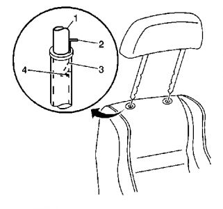

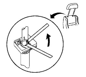

how does one remove the head rest from the front bucket seat of a 2006 buick rendezvous.
Feb 28, 2009 at 10:23 AM
BRIAN 1
  • 1,030 POSTS
Head restraints are the double-post type that are adjustable either up or down. Only the solid type head restraints have serviceable trim covers. Use J 42372 in order to remove the head restraints. Raise the head restraint to the full up position. Push the head restraint down just far enough in order to center the locking clip in between the detents (3) on the posts. Insert the J 42372 down the detent side of both posts (3) slightly off center of the detents. Push the head rest removal tool over and down to the detent making sure to keep constant pressure on the tool to grab and move the clip away from the detent. Push down on both of the tools on both sides and lift the head restraint out. It may be necessary to have help pulling on the head rest or pushing on the tool. Installation Procedure Push the head restraint to a full down position in order to install the head restraint posts (1) into the guides (4). Raise the head restraint in order to ensure that the restraint stops at the detent (3). Return the head restraint to its original position.
