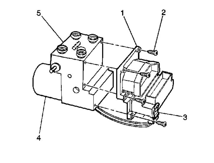

My ABS light came on so I took it in they say I need a new ABS module but I want to do the repair myself can you help me please?

I attached the procedure for you below with some pictures for the repair.
https://www.2carpros.com/articles/how-to-replace-a-abs-controller
After installing, you will need it programmed to your cars VIN in order to work.

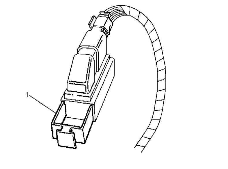

Notice: Always connect or disconnect the wiring harness connector from the EBCM/EBTCM with the ignition switch in the OFF position. Failure to observe this precaution could result in damage to the EBCM/EBTCM.

3. Disconnect the electronic brake control module (EBCM) harness connector.

5. Disconnect the pump motor connector (3) at the bottom of the EBCM.
6. Important:
^ Do not damage the seal by prying the EBCM from the brake pressure modulator valve (BPMV).
^ Do not damage the solenoid valves while removing the EBCM from the BPMV.
Remove the 6 EBCM to BPMV screws (2).
7. Separate the EBCM from the BPMV by gently pulling apart until separated (1).

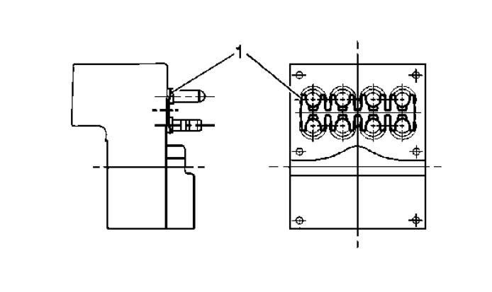

1. Important: Use only new wave springs and screws supplied with the new EBCM.
Clean the BPMV surface with alcohol using a clean towel.
2. Install the EBCM (1) to the BPMV.
3. Notice: Refer to Fastener Notice in Service Precautions.
Install the 6 screws that attach the EBCM to the BPMV.
^ Tighten the top 4 mounting screws to 5 Nm (44 inch lbs.). Tighten screws in an X pattern.
^ Tighten the bottom 2 mounting screws to 5 Nm (44 inch lbs.).

4. Connect the EBCM harness connector and depress the locking tab (1) to secure.
