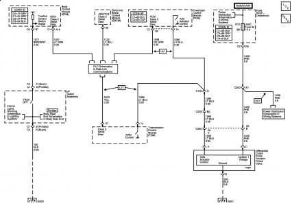

AWD DISABLE, MESSAGE IS ON IS THIS A HARD JOB TO REPAIR. COULD THIS HAVE BE CAUSED BY NOT CHANGING ALL 4 TIRES AT ONE TIME
May 24, 2009 at 1:09 PM
DENNYP
  • 1,824 POSTS

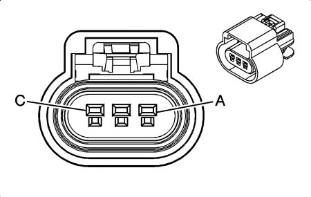

All 4 tires must have the same rolling circumference in order for this system to work properly. The tires must be replaced as a full set. Follow this diagnostic procedure to diagnose the clutch pump actuator.
https://images.2carpros.com/forum/automotive_pictures/102900_646415_1.jpg
https://images.2carpros.com/forum/automotive_pictures/102900_diff_2.jpg
