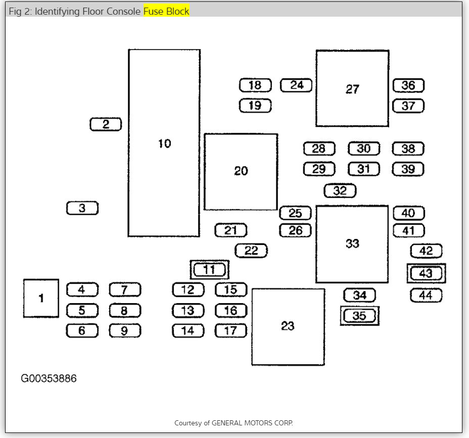

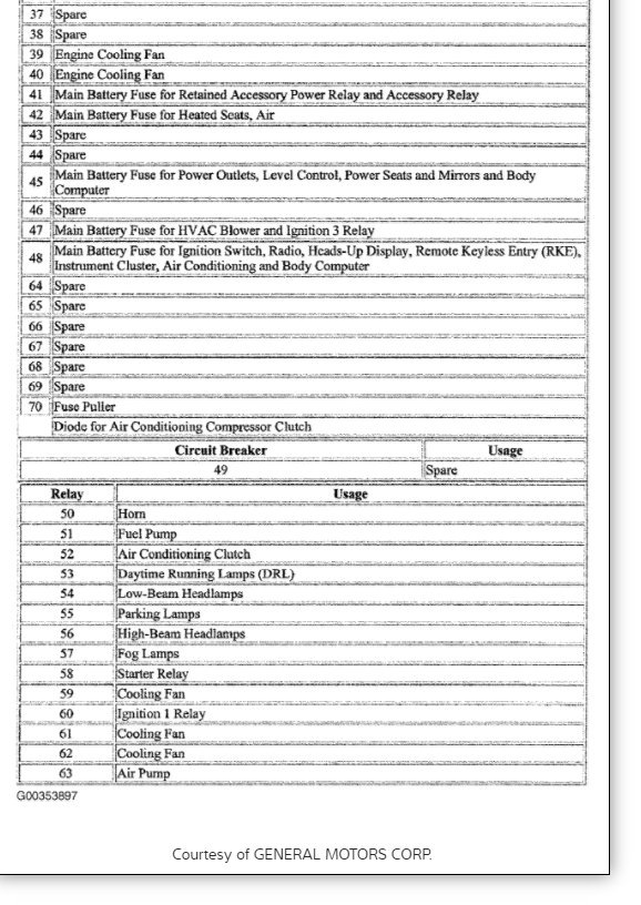

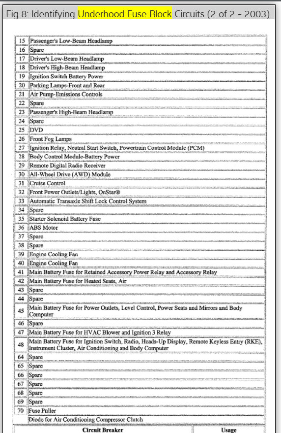

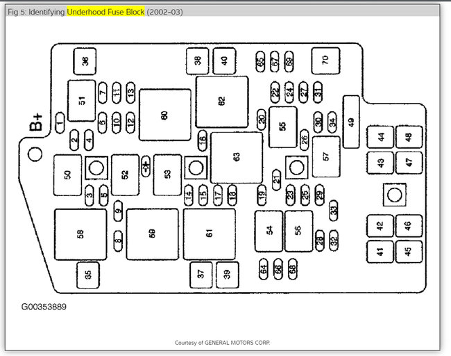

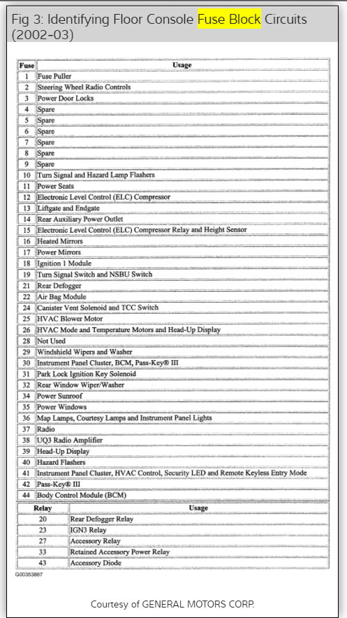

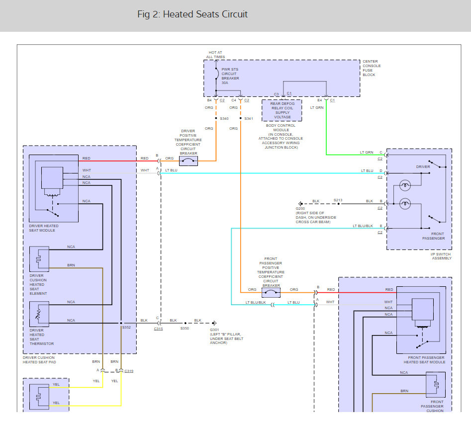

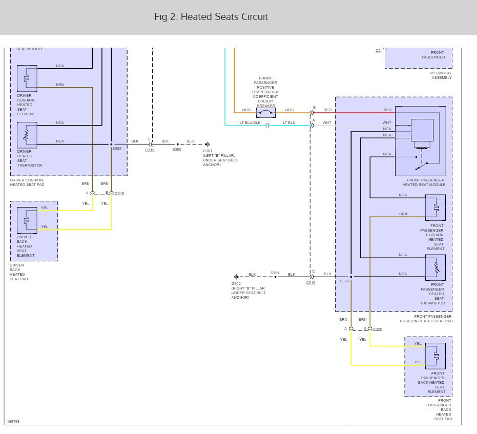

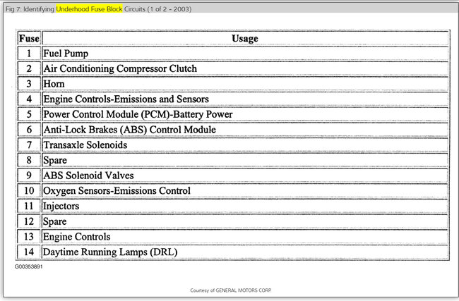

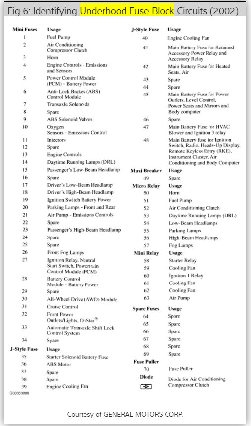

The system is amazingly simple they have a fuse a switch and a control module. Lets check the power source which is a 30 amp breaker and then go from there. Here is a guide to help you see how to check for power and ground along with a guide on how to check the fuse.
and
Here are some heated seat wiring diagrams and the fuse locations (below).

If the passenger seat works, then the fuse is not your issue. You will have to troubleshoot by following the wiring diagram and testing with a test light. https://www.2carpros.com/images/external/105720980.gif

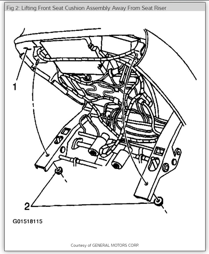

The driver side seat heater quit working all of a sudden. The switch indicator light still comes on when the switch is activated but no heat follows. The passenger side has continued to work without problems. I assume they are on separate fuses? Checked under the seat to see if any wires were visibly damaged or disconnected. None found. Any ideas on how to trace down the problem with a multi-meter (Unfortunately I have no schematic).

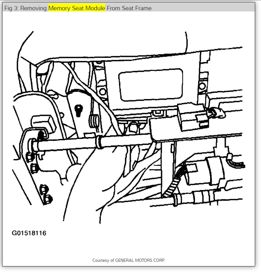

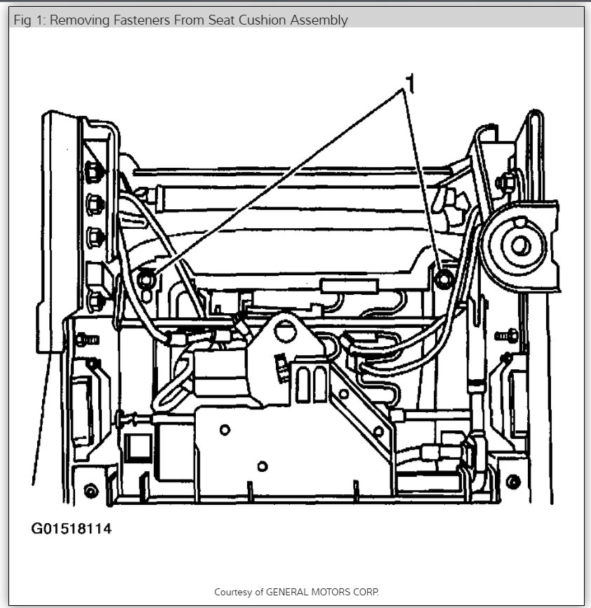

you need to replace the seat heater elements in the driver seat.

Most of the time the heater element in the seat goes bad.Do you have a multi meter to do some testing?
