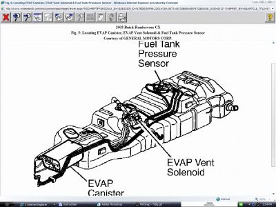

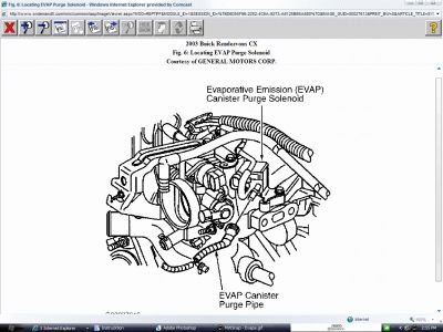

2003 Buick Rendezvous 6 cyl All Wheel Drive Automatic 106000 mile
Evaporative emission control system vent valve
Where is it located at?
How can i replace it?
Thankyou
Mar 9, 2008 at 6:50 AM
MERLIN2021
  • 17,250 POSTS
Which one? PCV is in vac hose on engine, Here are the others...
https://images.2carpros.com/forum/automotive_pictures/62217_Evapa_1.jpg
https://images.2carpros.com/forum/automotive_pictures/62217_Evapb_1.jpg
