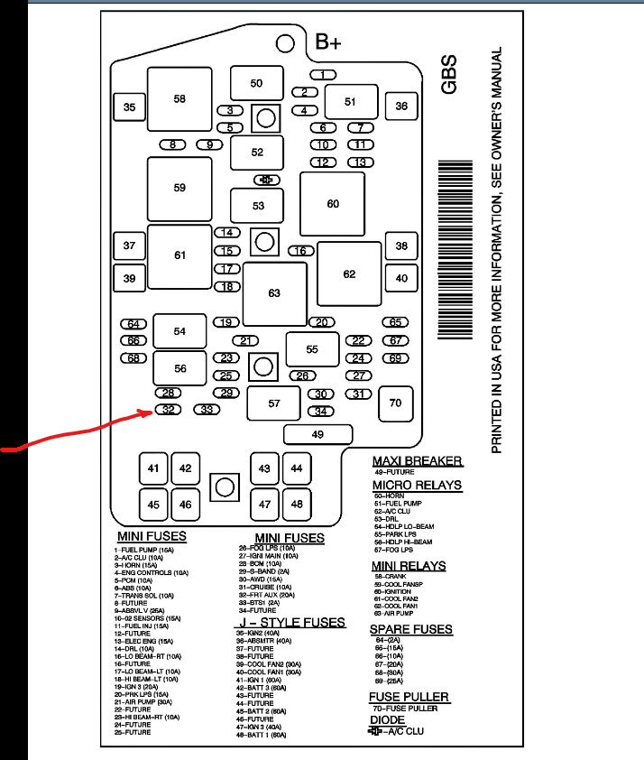

I have a 2003 Buick Rendezvous that seems to be running on 5 cylinders. I took it to Auto Zone for a diagnostic check but was told that a diagnostic link fuse was blown and needed to be replaced before they could tell me what cylinder wasn't hitting. I checked the fuse box but do not know what fuse to look for. The Owners Manual has the fused identified by numbers.

Yes the fuse is the FRT AUX in the front fuse panel here is a guide to help and the location under the hood as well.
Check out the images (Below). Please let us know what you find.
