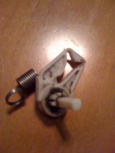

One more thing if i could ask you is when i pulled off the panel to get to the blower motor this part fell out and I could not find where it goes.https://www.2carpros.com/forum/automotive_pictures/558307_photo_1.jpg" alt="
https://www.2carpros.com/forum/automotive_pictures/558307_photo_1.jpg" />
https://www.2carpros.com/forum/automotive_pictures/558307_photo2_1.jpg

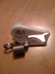

Here is another picture.
https://www.2carpros.com/forum/automotive_pictures/558307_photo_2.jpg

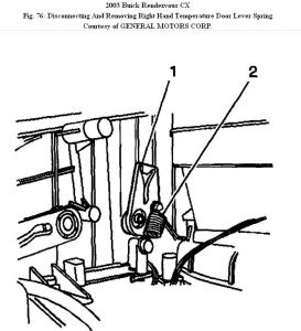

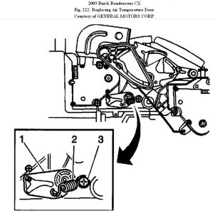

It is the lever for the air temperature door.
https://www.2carpros.com/forum/automotive_pictures/192750_AirTempDoor03BuickFig222_1.jpg
Friday, August 6th, 2010 AT 9:57 AM
ICE121006
  • 6 POSTS
I guess since it fell out when I removed the panel it goes up there somewere. Where does it exactly go?
And also what does it do? If I leave it off what effect would I have?
Thanks very much for all of your help.
Friday, August 6th, 2010 AT 10:26 AM
KHLOW2008
  • 41,814 POSTS

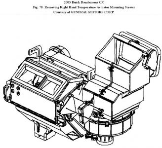

It is for control the air temperature, ie a switch between the heater and A/C. Leait unattached can cause problems with the heater and A/C temperature.
It is on the heater housing at the side. You can see other linkages and levers nearby.
If your vehicle has Auto HVAC then the diagram could be different.
https://www.2carpros.com/forum/automotive_pictures/192750_AirTempDoor03BuickFig76_1.jpg
https://www.2carpros.com/forum/automotive_pictures/192750_AirTempDoor03BuickFig78_1.jpg
