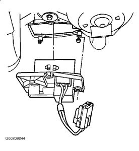

The heater fan on this vehicle only works on full speed. I believe there is a resistor in the circuit that controls the fan speed, but I have no idea where it is or what it looks like. I am fairly competent with tools but I don't want to take out the dash. Can you give me an idea what to do to replace this part, if indeed it is the problem?

It is located behind the glove box in front of blower motor.

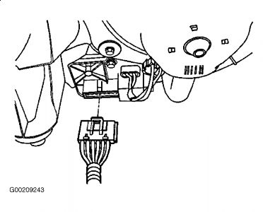

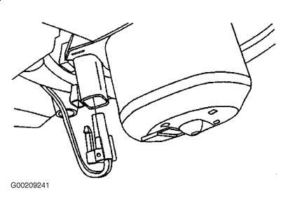

Hello - Obxautomedic were working together on this........here is more info for you. BLOWER MOTOR RESISTOR ASSEMBLY Removal 1. Remove the right side instrument panel insulator. Disconnect the blower motor electrical connector. See Fig. 24 . Remove the blower motor mounting screws.
https://images.2carpros.com/forum/automotive_pictures/248015_24_4.jpg
NOTE: Only loosen both of the forward blower resistor assembly mounting screws. The blower motor resistor assembly mounting holes are slotted. 2. Remove the blower motor from the HVAC module assembly. Disconnect the electrical connector from the blower motor resistor assembly. See Fig. 26 . Loosen the forward blower resistor assembly mounting screws.
https://images.2carpros.com/forum/automotive_pictures/248015_26_3.jpg
3. Remove the rearward blower resistor assembly mounting screw. Remove the blower motor resistor assembly from the HVAC module assembly. See Fig. 27 .
https://images.2carpros.com/forum/automotive_pictures/248015_27_2.jpg
